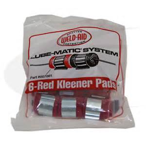

You can add a cleaning pad and/or a lube pad where the wire enters the feed roller block to reduce contamination in your liner. Here's an example:
In the image on the bag, the red pad is a cleaner, and the black pad rubs a microscopic amount of weld-compatible lubricant on the wire to allow it to feed through the liner easier.
With the knurled rollers, it's entirely possible to be too tight, and leave sharp indentations in the wire, which will also give you trouble.
- lube pads.jpg (11.43 KiB) Viewed 6681 times
