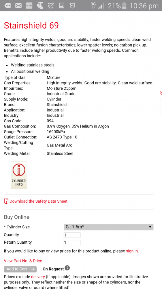

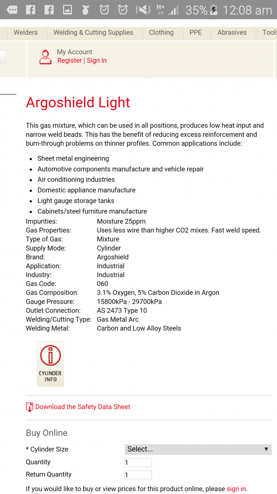

For the non Australians wondering what Argosheild and Stainshield gas is.
Just noticed the Argosheild I have contains Oxygen. Introducing oxygen to the weld puddle would cause the weld to rust wouldn't it?
- Screenshot_2015-06-24-00-08-13.png (316.55 KiB) Viewed 1750 times
- Screenshot_2015-06-24-00-06-00.png (298.41 KiB) Viewed 1750 times
Given those two options, my preference would be the Stainshield, but for exhaust tubing, you will likely be pleased with the Argoshield. Exhaust tube being thin by nature, I'd think the 1% H2 in the Stainshield would make heat control an issue. The Argoshield, on the other hand, will likely give you a dark weld surface due to the O2 content, but very aggressive wire-wheel treatment with a grinder (new SS wire wheel) should polish that up reasonably well while leaving your bead appearance (mostly) intact. SS exhaust will discolour some naturally, anyway.
Still, nothing beats a He/Ar mix for SS, but in many places it has priced itself out as an option.
By the way, a co-worker and I experimented with pure He for SS MIG. POOR results. The other stuff is there for a reason.

Stainshield 69 sounds like an excellent compromise, especially for thinner sections. As long as it's affordable.
I have unlimited access to helium, so I forget what it costs folk who have to buy it.
That 0.9% O2 will give you some heat, so expect to move quickly, but I'd have no fear of welding tube with that blend.
Thinner wire and lower setting are your friend.
