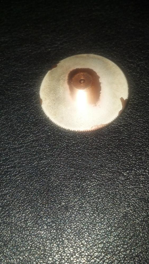

My local welding supply asked my to try out this BorNIGuard ceramic coating for MIG nozzles. I have not run it a lot but will have to say it seems to work well. It is pricey so I am not sure yet if it is something I will invest in. Anyone here use this stuff? Was wanting to see others feedback and share this product as well.

how long does an application last? I have always used nozzle gel, which is pretty cheap and requires frequent reapplication
I have heard it is advertised to last a 8 hour shift. In my opinion the cost savings would come from not having to stop and re-apply nozzle gel or anti-spatter. I have at max 4 hours on the nozzle in the picture, so I would say it is doing its job. I cleaned the nozzle once and the spatter fell right off.
It lasts a long time if you are careful as i said, and because the nozzle is always pretty clean its easy to reapply. Also because theres no need for heat like with dip, you can give it a quick spray just before lunch or whenever.
I actually am liking this ceramic spatter guard. It does seem to last longer than anit-spatter. I also have sprayed a table with it and it works well.

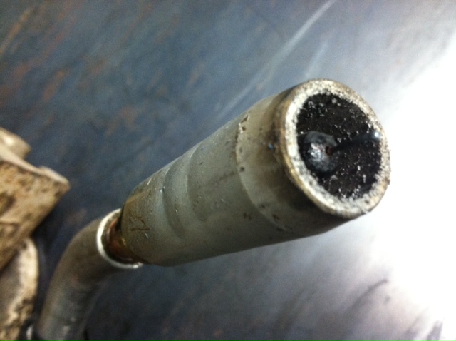

I have been mostly using it in short-circuit transfer. I have a Bernard eliptical set up I have done nothing but short circuit on and it has help up extremely well. I would say one/two applications will last a 8 hour shift just fine, as long as you don't scratch it all off in cleaning. It takes so very little effort to clean the nozzle. I did do the pipes found toward the end in "what I welded today" in spray and it held up fine. I am beginning to wonder though, if the caramic transfers heat to the neck and gun. In the pic I am using .035 self shield on a friends very rusty trailer and while the ceramic spray is fine my plastic is not. It could be that I am just pushing the gun to much, don't care for the M25 but I didn't want to drag out the 25' gun. I would guess that there is 3-4 hours of actual weld time in the pic. I want to test it at 250+ amps but have not had the opportunity yet.

from your pic i looks like your spraying the entire nozzle on the gun? next time just spray the last inch or so of the nozzle inside and out let it dry and see if it works betterSuperiorwelding wrote:Steve,Otto Nobedder wrote:Jonathan,

I will do that! Do you have any experience with this or a similar product?mikek wrote:from your pic i looks like your spraying the entire nozzle on the gun? next time just spray the last inch or so of the nozzle inside and out let it dry and see if it works betterSuperiorwelding wrote:Steve,Otto Nobedder wrote:Jonathan,

similar product, cant remember what brand anymore. but if you use it properly the fiberglass in the base of the cone will wear out before the cone shows much wear. also did not have much luck spraying the tip (even blocking off the wire hole) good luck have fun!
