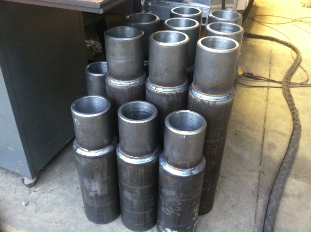

Had a rush job today. Customer needed these DOM tubes welded for something used in the Frack industry. The only catch in these welds was I had to get the weld as close to the edge of the tube without to much of it off. Was a fun little job. I love using the rotisserie!

JDIGGS82
    Sun Jul 21, 2013 10:46 pm
That is slicker than snot on a doorknob

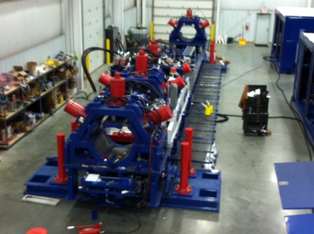

For those who want to know what I do at my day job, here it is. Our patent was published a few months ago and we are realeasing these videos to the public so now I can share. This has been a 5 year project thus far and will have a couple more years until everything is completely done. The machine pictured is designed to be used in mainly tunneling applications but we will be also targeting open trench as well. We built everything on the machine from a pile of steel and had machining done elsewhere. In its current state it will push 30" 3/4" wall pipe for 5 miles up a 2* incline, generating 1.2 million pounds of max thrust. A complete stroke takes less than 3 minutes, so our hold up is the welding. The clamping system can be changed to accept 8" up to 42" pipe. The rollers I posted earlier in this thread can be seen in the first of the video. I am in the middle of designing a welding station to incorporate orbital welding to increase production and allow the machine to operate efficiently. Soon I will post actual pictures of the machine as it is a little different than the video. There are clamps at both ends in real life, not one. Anyway thought I would post this up.

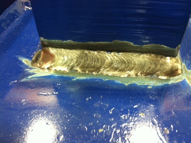

Might as well put this up too. Trying out my Cougar pistol gun and loving it! Here's the best I have do far. Won't bore on specs as there are to many for this. Feel free to advise how it can be better.

Very nice drifta-x! What are your specs on that and did you whip those beads? Looks kinda line there is a weave pattern.
Drifta-X
    Mon May 26, 2014 2:53 am
    Melbourne Australia
8m/min. 24.3volts
That pic is side on. Bottom being right side. (Vert up)
2nd pass that is (cover)

Superiorwelding wrote:For those who want to know what I do at my day job, here it is. Our patent was published a few months ago and we are realeasing these videos to the public so now I can share. This has been a 5 year project thus far and will have a couple more years until everything is completely done. The machine pictured is designed to be used in mainly tunneling applications but we will be also targeting open trench as well. We built everything on the machine from a pile of steel and had machining done elsewhere. In its current state it will push 30" 3/4" wall pipe for 5 miles up a 2* incline, generating 1.2 million pounds of max thrust. A complete stroke takes less than 3 minutes, so our hold up is the welding. The clamping system can be changed to accept 8" up to 42" pipe. The rollers I posted earlier in this thread can be seen in the first of the video. I am in the middle of designing a welding station to incorporate orbital welding to increase production and allow the machine to operate efficiently. Soon I will post actual pictures of the machine as it is a little different than the video. There are clamps at both ends in real life, not one. Anyway thought I would post this up.
http://www.youtube.com/watch?v=jEKh_FrPM7E
Impressive!
It seems to be based on current "line-bore" technology for pushing small-bore pipe and conduit under obstacles, but done "on steroids"!
    Thu Jan 24, 2013 10:13 pm
    Eddy, TX
Steve,
You are correct. It's basic structure comes from directional drills. If we added the gear box we could drill with it as well. I will get a few pictures of the actual machine soon.
Edit; here is a pic of most components on the machine. At this point there was alot of hydraulics, wiring and assembly left.
