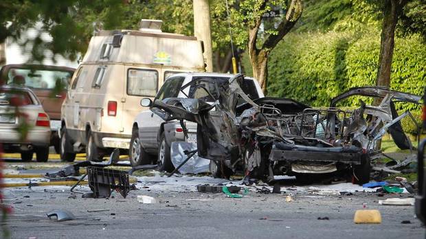

While I'm on my soapbox,
I'd like to remind everyone not to transport or store acetylene bottles on their sides, unless you can afford to let them stand unused for a few hours after.
Acetylene is not bottled as a gas under pressure like oxygen or argon. It becomes unstable and highly reactive above 15 PSI, which is why your regulator has that red line from 15 psi up.
Acetylene is dissolved in acetone, in a fiber substrate in that bottle. Storing it on it's side allows acetone to accumulate at the valve, and it must be allowed to settle out. Blowing acetone, a strong solvent, through your regulator and lines is not healthy for your torch.
My brother woke up in Vancouver yesterday, when his apartment building shook.
The story pretty much explains it all. A plumber storing acetylene in his vehicle.
I wonder what his insurance company has to say about this policy?
http://www.theglobeandmail.com/news/bri ... e12057894/

Otto Nobedder wrote:While I'm on my soapbox,
Acetylene is not bottled as a gas under pressure like oxygen or argon. It becomes unstable and highly reactive above 15 PSI, which is why your regulator has that red line from 15 psi up. Acetylene is dissolved in acetone, in a fiber substrate in that bottle. Storing it on it's side allows acetone to accumulate at the valve, and it must be allowed to settle out. Blowing acetone, a strong solvent, through your regulator and lines is not healthy for your torch.
- car explosion.JPG (52.13 KiB) Viewed 2152 times
welderkid556
- welderkid556
Joined:Sat May 11, 2013 1:21 am
well thats an interesting story and a nice photo. ive heard about people transporting oxygen tanks in the trunks of cars and somehow the valve gets knocked off and blasts through the car, ripping the body in half. i live maybe half a mile from my welding supply store that refills gases and refilled tanks, i take my old tank over in the back of my truck in a secure spot, and exchange it with a new bottle then go right back home and pack it inside because i cant roll it through the mud and ive never had any problems but we also use caps over the valves, always. our welding supply store will not accept a tank with a cap missing.
