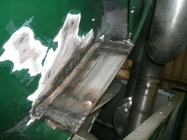

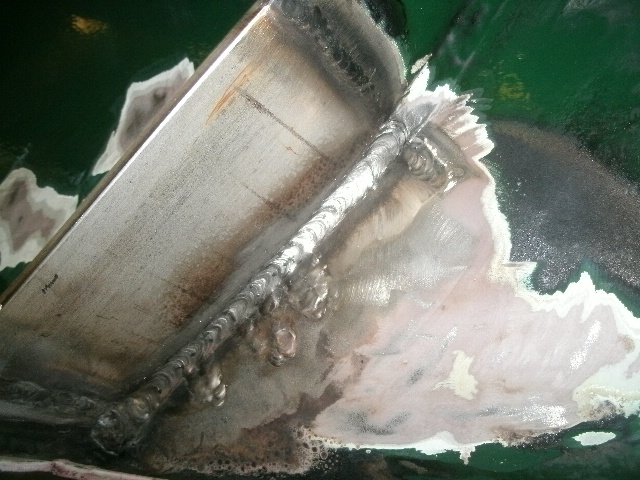

Here's a couple of shots of 1/4" stainless to 1/2" stainless, a tee joint, where I replace a section I had to remove to repair stress cracks that resulted in a vacuum leak.
Here's the "flat" 1F (the slope is about 30* at this location).
And here's the opposite side, 4F, at the same 30*
Outside the MIG weld in both are TIG welds used to fill where I ground out stress cracks.
Oddly the most difficult weld all day was small. I had to TIG it left handed, almost standing on my head to feed the rod, with the shortest cup and back-cap I have on a WP-20 torch. This was the bottom side of a stop-drill hole I needed to localize the vacuum leak that led to the repair.

NIce work. Looks like some really tough positioning.
I have definitely be there with the difficult positions for TIG. I have had to sit or use my shin on the foot
pedal to get a few jobs done. Sometimes thats what it takes.
Nice work!
