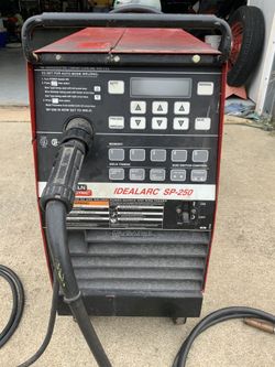

Even with that, it took like 10 passes to fill the groove. That SP250 would have come in handy. Looking at the manual, it has a 100% duty cycle at 150 amps
Someone else snapped this up before I could get to it. I think a 250 amp mig on hand would be nice to have. I keep looking and now Matco 260D is up for sale close to me. It comes with the optional spool gun included. Seller wants $800 for it.

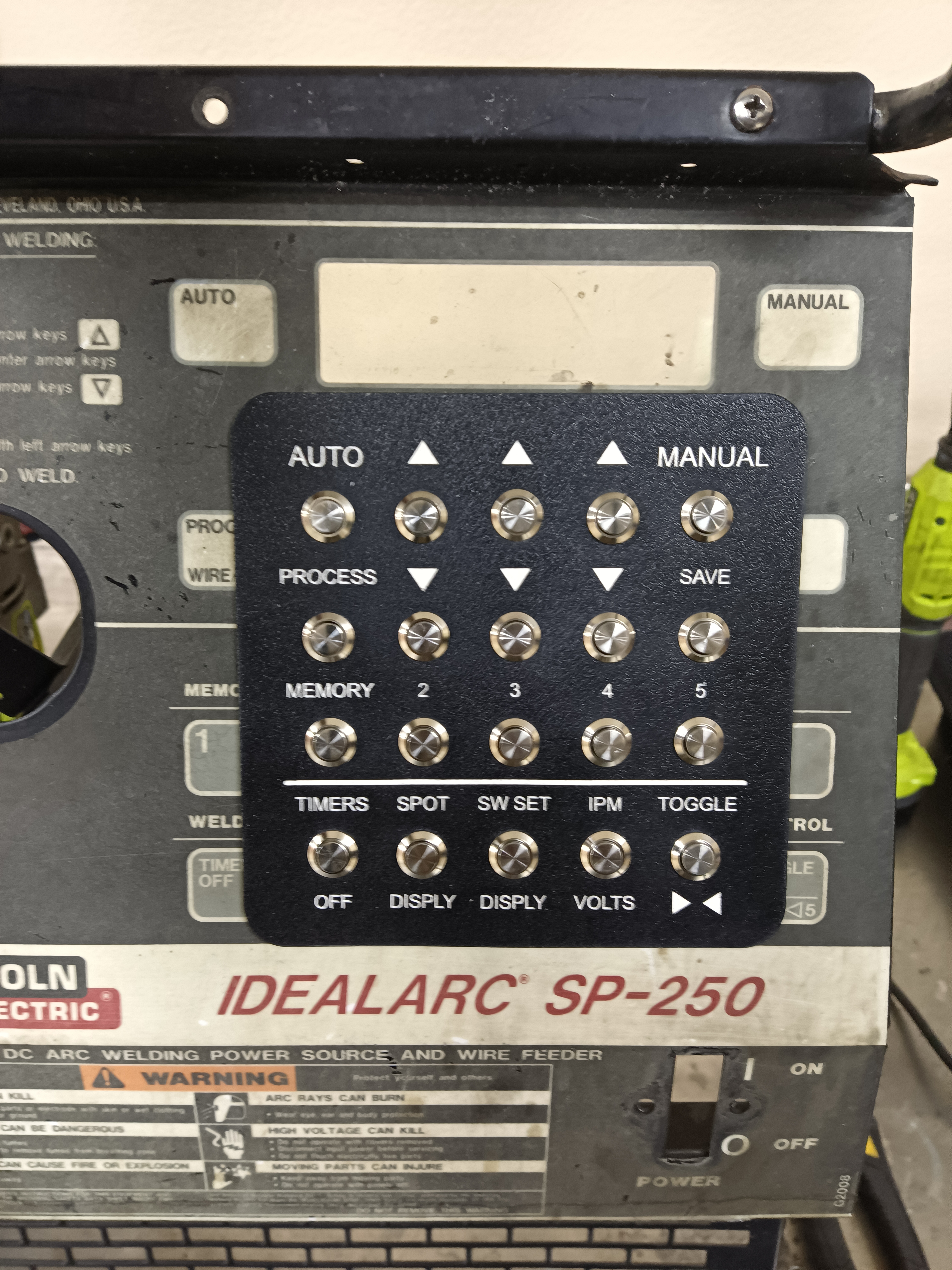

I have one of these machines that started acting up. It has a membrane touchpad for controls. It goes bad and is impossible to find. So, thinking outside of the box I made a replacement keypad array. Works great. I didn't take a pic with it all wired up. but manual available online shows how the switch array is wired.
