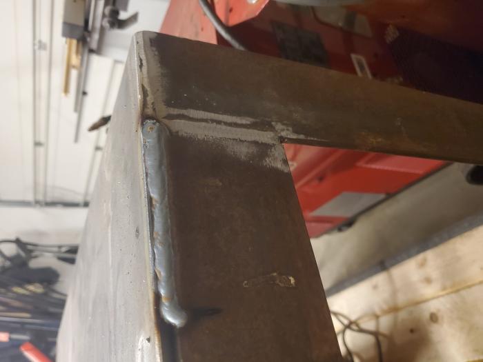

The new machine seems to work pretty good for now atleast..... could use a better operator
- 16254988627684080507937663299549.jpg (30.26 KiB) Viewed 3347 times
Broc - if you’re MIG welding horizontal like that, hold the upper edge 2x as long as the bottom. Whip across the middle. Gravity will take care of the rest. And do try to be as “straight in” with your torch angle as possible.
