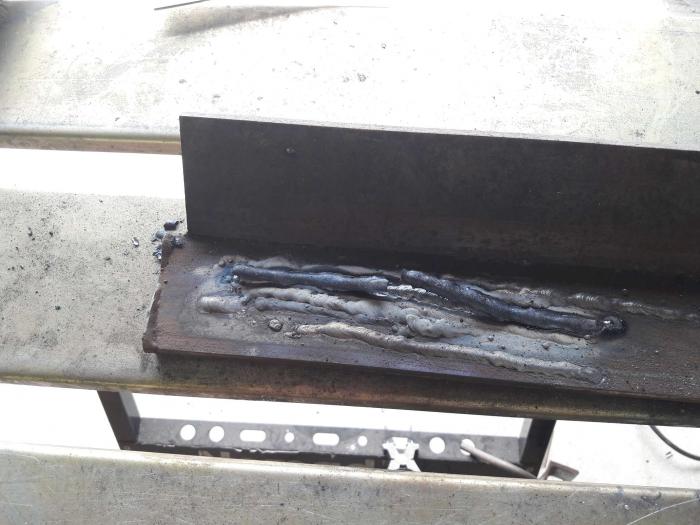

OK let me start my saying I am an absolute beginner. I have attached 2 pictures of my flux core arc welding attempts.
andyTriesToWeld
- andyTriesToWeld
Joined:Mon Feb 03, 2020 8:07 pm

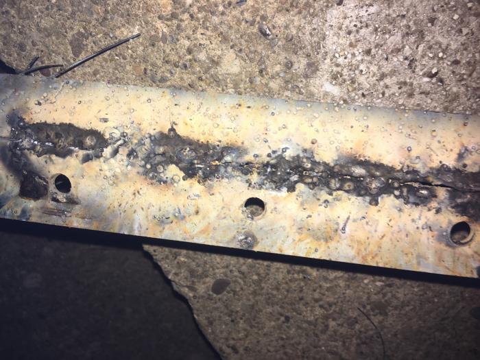

Welder is the Harbor Freight basic entry level $100 flux core arc welder. It has low and high. I set it to high. Wire feed speed set to 5 out of 10. Metal is 1/8" thick hot rolled steel. I was joining it to a large L bracket. No idea what the L bracket is made of.
The other picture is where I tried to mend the inset for my table saw.
Do I need to clean/prep the metal?
Yes clean steel always welds better. Are you able to get a stable arc or is it trying to "pop" a lot? Meaning, if it is, you need to make adjustments to your wirefeed speed. Are you clamped directly to the work? If not, then you should.
go find the nearest bin and go throw that heap of crap welder into it.andyTriesToWeld wrote:Welder is the Harbor Freight basic entry level $100 flux core arc welder. It has low and high. I set it to high. Wire feed speed set to 5 out of 10. Metal is 1/8" thick hot rolled steel. I was joining it to a large L bracket. No idea what the L bracket is made of.

flux core in itself is not an issue. the problem is it can be touchy to dial in, even on my mig the settings have to be just right for it to run well. trouble is your machine has crude adjustments, you simply cannot dial it in. so your always going to be fighting the machine.
btw its not about you making the machine do what you want, its about you learning to weld. two very different things.

Cheap, low powered welders running flux-core wire do NOT like thin metals! Add to that, the fact that flux-core wire "burns" hotter than solid core wire. Even spot welding thicker sheet metal without burning through is a real bear with one of these welders.
The material must be CLEAN!!! You don't have enough power to blast thru any crud.

The biggest problem with those cheap flux core welders is that they are AC and flux core wire hates AC. However there is hope, for about $40 or so most of them can be converted to DC. It's not hard and the parts are easy to find. A simple Google search will yield lots of info.

they don't like thin material but don't have enough power for thick materials, doesn't leave much to work with. being AC or DC negative reduces their 'heat' output so you need more amps which they don't have a lot of.
flux core can require fairly precise settings for it to run really well, but cheap welders don't have that.
i don't recommend manipulation like "e"'s as that can trap slag.
but mostly its the simple fact theres more to go wrong, more settings to screw you over. you never quite know if its the machine causing the issue or you.
that makes learning very very difficult.
this often means you learn to weld poorly.

Yes, upgrade the wire to Hobart's E71T-11. It will help a lot. The GS wire won't weld to a previous weld. The hobart wire is multi-pass wire. Slow down the wire feed also. My first welder was the same one. 3 was about as fast as mine could handle. It slows the process down and will get decent penetration. Flux core is a messy process, but it does work. That machine's max will be 1/8" material. Just slow down the wire feed and practice. A better machine would be about any dc welder. I have the Titanium flux 125 and its a pretty solid welder. Best of luck.
