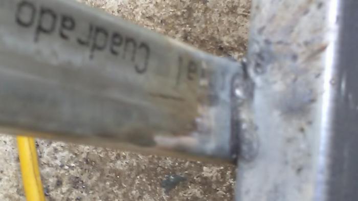

This weld was with the setting at MAX with .035 Blu3 D3mon wire. I can see what others talked about that wire, spatter is almost the same..............one of the conversion said he used 2 things only, the Bridge Rectifier and the capacitor, I guess he discharges the capacitor by touching the ground clamp with the electrode after turning welder off, is this a good idea? Or should I wait to find how to make a choke and find the proper resistors to drain the capacitor? Thanks..................AZ

Can you get a tighter weld shot, in focus? That would be helpful for troubleshooting.

I can try but photos are from my cellphone........the tubes are galvanized, I use a air filter mask............the first welds I tried were hudge pop corn, like the actual size of a pop corn lol, I haven't finished the fence, so I have more welding to do, I will weld after I finish the AC to DC conversion............thanks to you all for helping, got a few more photos to upload.............AZArtie F. Emm wrote:Is that galvanized steel? If yes keep your head out of the smoke plume, the fumes are toxic.

Check this photo, still from my cellphone but I tried my best to take non blurry hoto.
