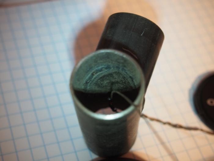

- Full Penetration
- P2080276.JPG (24.51 KiB) Viewed 3299 times

I have attached some photos of some sample welds I made. Notice the small heat effected zone. Also notice the inside or back side of the weld (inside the tube). You can see that there is full penetration around the joint (beads or bumps inside the tube).

- P2080274.JPG (25.88 KiB) Viewed 3296 times
- Simple Mig like Tig welded joint
- P2080275.JPG (24.51 KiB) Viewed 3299 times

Make sense to me.
The testing, even without controls, is hard to argue, as well.
Thanks for sharing!
