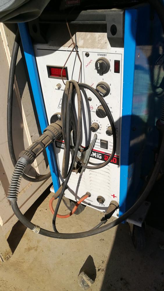

Hi guys and gals, any one got experience with this unit in pic? Good, bad or otherwise. It was prior to the Chinese built units. Guys selling this one and I need some more amps and thing has done no work whatsoever. Any help appreciated. Cheers.

I have a similar 250 , mine has the remote wire feeder. Plenty of these machines out there, single roller drive, basic migs.
I heard complaints about them but I’ve taken the time to look at the the so called problem machines and in every case there was an explanation including mismatched drive rollers to wire, incorrect drive roller tension, worn or clogged liners, insufficient power supply.
When set up correctly the machine will give very good reliable service. As delivered it is fitted with a power cable and plug suitable for 15 amp circuit. If you want full output you need to fit a 4mm2 cable and plug to a 32amp circuit. That’s what I did with mine and it works great.
If it’s the right price, go for it. Parts easily available, no risk.

Awesome, thanks mate.not super cheap but like new, he wants $1000.00 I’d rather pay that than 1500 for a Chinese machine I can’t get parts for. Thanks again mate,Coldman wrote:I have a similar 250 , mine has the remote wire feeder. Plenty of these machines out there, single roller drive, basic migs.

Probably a bit steep at $1000.00, but is as new and aus built......I’m running a 180 and it’s been playing up lately so thought it might be an option...weldin mike 27 wrote:Just saw above. I want to buy a 250 mig but I don't have available funds.

Have a look through ebay and you'll see that all the reasonable 250 amp migs are around that price maybe he'll come down a bit, maybe he won't. An Australian made cigweld will definitely be better than most
I think the price is reasonable for what it is and it’s condition, I just want a reliable unit that is fixable if it breaks down, something that seems to be a thing of the past with some Chinese manufactured units(the cheaper ones) but having said that, my tig cost a bomb years ago and I struggled to get that fixed when the hf crapped out.....weldin mike 27 wrote:Have a look through ebay and you'll see that all the reasonable 250 amp migs are around that price maybe he'll come down a bit, maybe he won't. An Australian made cigweld will definitely be better than most
