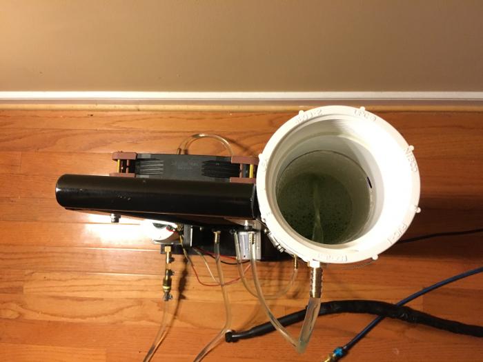

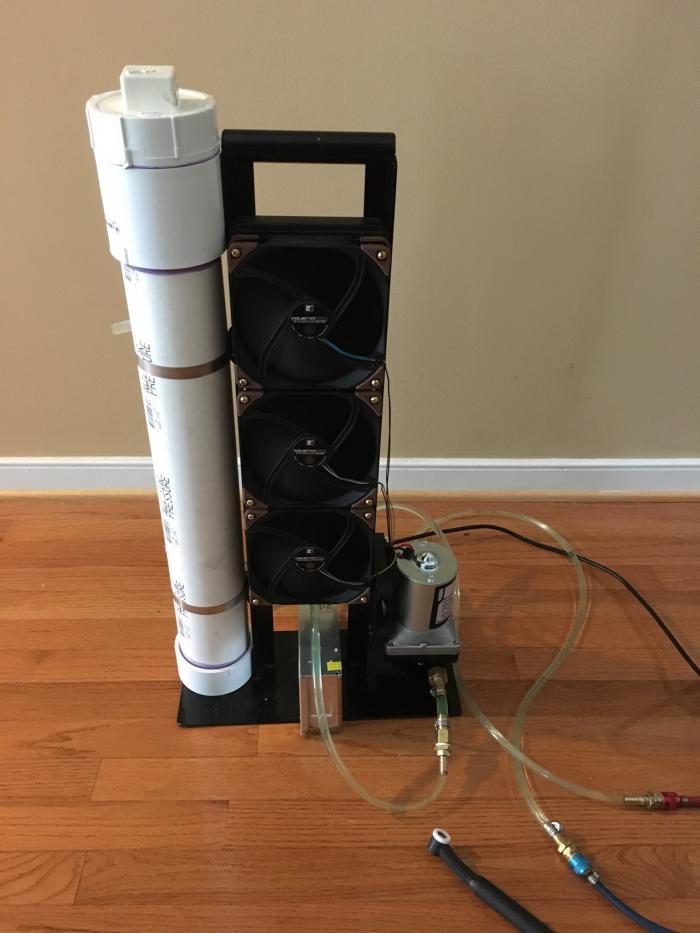

So I've seen plenty of tig coolers here but a lot of them seem like they probably cost more to make than just buying one would.
So this was under $200 and came together pretty fast. This is framed out with just a 11 gauge sheet for the bottom, a few feet of of 1" angle iron and some 1" tube for a handle. Flow rate ends up as about 2 LPM which is plenty and operation is fairly quiet.
Here are the primary components:
http://www.amazon.com/SNANSHI-Switching ... CPF0VN02MD
http://www.amazon.com/SHURFLO-4008-101- ... PDKIKX0DER
http://www.amazon.com/Rosewill-Sleeve-C ... 29QT0IENFR
http://www.amazon.com/XSPC-EX360-Radiat ... W9A986D3KF
http://www.ebay.com/itm/262010461740?_t ... EBIDX%3AIT
The fittings on the pump are kinda kludgy but I'll blame home depot for their selection...

Can't say I've had many occasions to run my machine that hard but that sounded like a reasonable test so I gave it a run. I let it run for 10 minutes to equilibrate to 72.1F then did two one minute arcs back to back at AC 200A 33% DCEP no pulse. The first minute got the temp to 75.3F and the second minute got it up to 75.6F. Torch body wasn't noticeably warm by the time I got my glove off but the quartz cup was pretty hot and the gas flow from the torch was warm. After a minute, the water was reading at 73.2F.Oscar wrote:Can you TIG weld at 200A+, AC with 65%EN and still have ambient temperature water exit the entire cooler after being cooled? All the compactness and savings don't mean squat until you do heavy AC TIG.other than that, good job.
My guess is that either the cup or the power line would slag before anything else now.

I actually tried a computer power supply first. Just bridge green to black for the motherboard power on signal and then the yellow wires are the 12V+ rail and black is ground. Mine was tripping off under load. Was a POS I'd pulled out of a junker at the office though. A real 12V psu was about the same price as a decent computer psu that I'd have to strip down.LtBadd wrote:Interesting build, would not a computer power supply work as well? Also what diameter is the PVC pipe, looks like maybe 3"?
Pipe is indeed 3" and 24" long. Total volume is a bit under a gallon.

No, it is 55 from the pump but after the restriction in the torch head it is much lower. Don't really have a way of putting a gauge on the return side. Why do you ask?Oscar wrote:is it maintaining 40-50psi on the return line?

pressure is checked on feed side of a pump,return like a water cooler is unrestricted and is usually checked for volume.
the pressure restriction would be the torch head, in this case.

Sandow wrote:No, it is 55 from the pump but after the restriction in the torch head it is much lower. Don't really have a way of putting a gauge on the return side. Why do you ask?Oscar wrote:is it maintaining 40-50psi on the return line?
-Sandow
My bad, I meant to say supply, not return line. That's good 55psi should take care of things quite nicely. I only ask because if the pressure is not high enough, the water may end up boiling in the torch head passages.

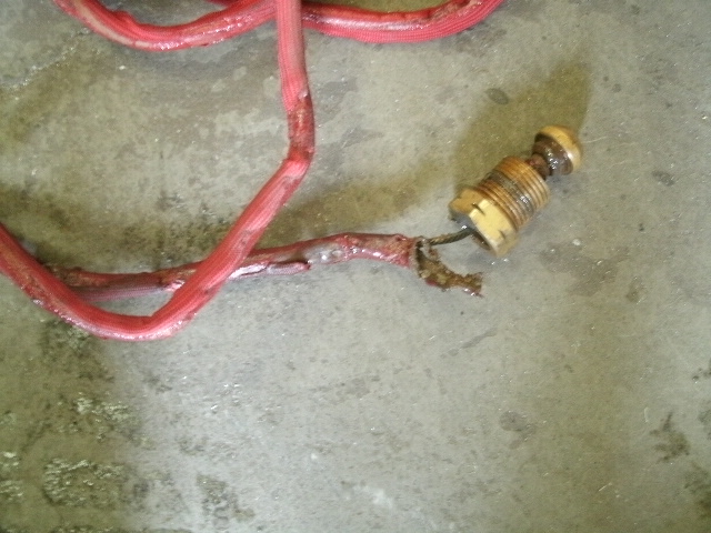

And restricting the flow looks like this:
I was welding aluminum overhead from a creeper, when I pinched the supply line with a creeper wheel. In seconds, 300A did this to the return/power line.
- GEDC1031.JPG (183.86 KiB) Viewed 2660 times

I think I've seen that before...hope you didn't get burned by the hot coolantOtto Nobedder wrote:And restricting the flow looks like this:
Yeah, I've put that one up before. I was wearing PPE appropriate for "meteors" from overhead aluminum, so, no, I was not burned.LtBadd wrote:I think I've seen that before...hope you didn't get burned by the hot coolantOtto Nobedder wrote:And restricting the flow looks like this:
That quote makes sense to everyone who welded overhead alum...damn that shits hot.Otto Nobedder wrote:Yeah, I've put that one up before. I was wearing PPE appropriate for "meteors" from overhead aluminum, so, no, I was not burned.LtBadd wrote:I think I've seen that before...hope you didn't get burned by the hot coolantOtto Nobedder wrote:And restricting the flow looks like this:
