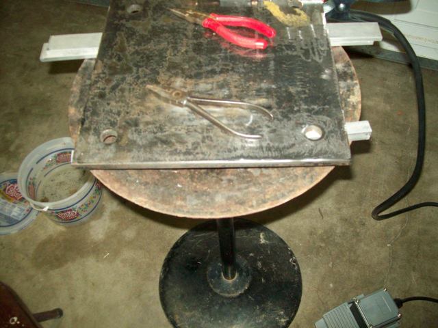

dmcnally
    Sun May 22, 2016 11:45 am
Thanks. Here's my welding table. I inherited some dollar coin vending machine stands and I never threw them out. I screwed a base on both ends and that's my welding table. The bases are cast iron and won't catch on fire. On top of the base I have a 12"x12"x3/8" piece of steel plate that's my welding surface. This works fine, and is comfortable, for doing practice beads.
My welding cart is a Harbor Freight moving dolly.
I move my car out of the garage and setup my little table when I want to use the welder. I'm in the process of getting rid of a few bikes (83 Honda CR480 and 92 Honda XR250) that I don't ride anymore. After the bikes are gone, and I have some room, I'll figure out a more permanent arrangement.
Dave
    Fri May 27, 2016 11:00 am
    Atlanta, GA
Nice. My table is an old transmission build table that I covered with a sheet of 3/32" aluminum. The aluminum is about 50 times as conductive as steel so nothing ever even thinks about trying to weld to it.
I bought my welder specifically with the idea of being able to weld thick aluminum so the water cooler on the bottom of my welding cart was an invaluable addition.
I forgot to plug it into the welder one time when I move things around and fried the water cooled torch that came with the welder. Then i melted the "9 aircooled torch that came with it while I was waiting for my CK torch to arrive. I really should have bought a flex head or flexloc torch because when I stopped practicing and started building stuff I discovered why the aforementioned torches are made and sold. All in all I think that the rigid torch is making me a better and more versatile welder though. Still wishing that I had a flexloc regardless.
Do yourself the same favor and get a sheet of aluminum to cover your table.....youll be glad that you did.
