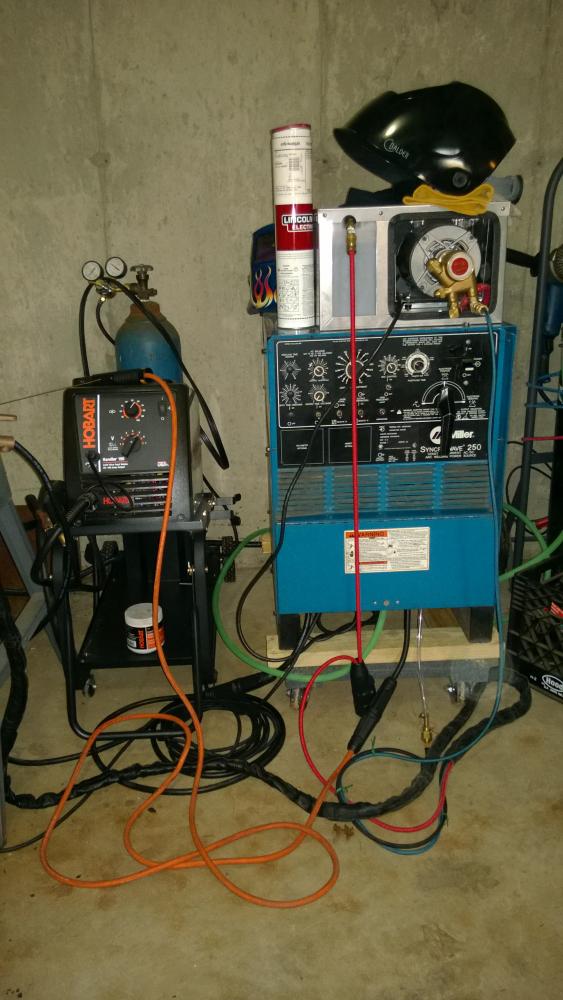

Here's what I did: I found this cooler on Craig's List for a song and a dance, and I picked up a CK 20 water cooled torch from HTP America (also for a very reasonable price). I plug the cooler into the front panel of the Syncrowave and leave the cooler on top. I built a pair of "tag leads" with a ring terminal on one end and female DINSE on the other end. Then I can switch between my stick stinger and TIG torch pretty easily.
- WP_20150317_003.jpg (83.24 KiB) Viewed 2604 times
