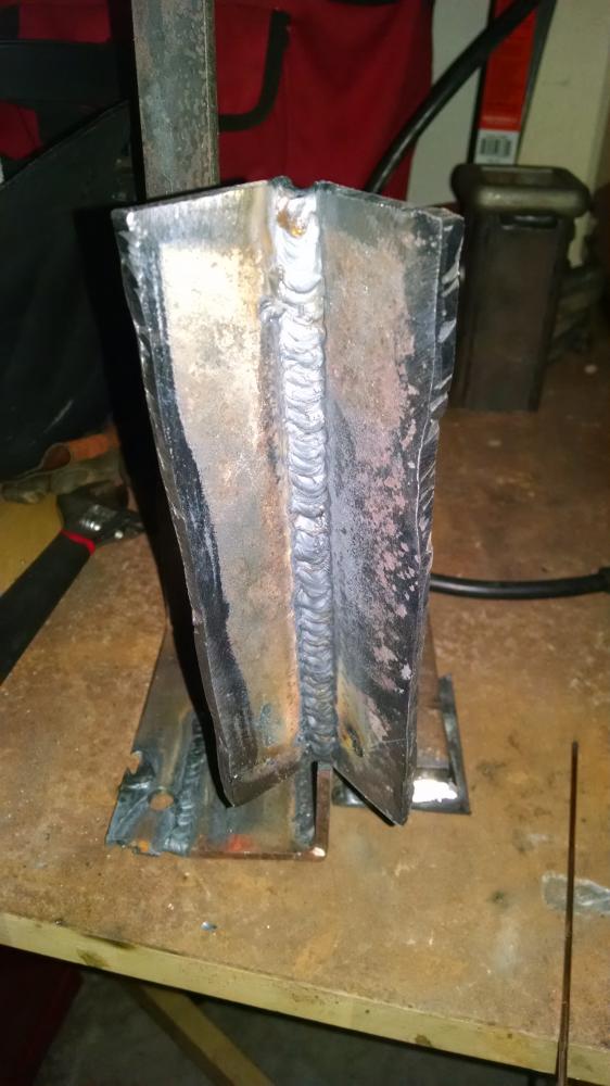

Update:
Went to the scrap yard today. Took my boy out and he had a great time stomping puddles and asking what each and every thing was lol. They had some 7", 8", and some 4" heavy wall, but no 6". It was all $6-$7/ foot!!! Wow, mucho expensive. So I got some 2-5/16" OD 1/4" wall that was ten bucks for nine feet. It still has the mill scale and the original writing on it. It was the best stick in the pile. But that heavy wall was some sexy steel. I want to try that lol
I ordered some cutting, grinding, and flap discs from Empire Abrasives yesterday that will be here tomorrow, and I will cut up some 3" long coupons to start practicing. I've been practicing walking the cup on vertical fillets for now and am somewhat pleased with my progress. I'm excited to be making progress like this. Stagnation frustrates the piss outta me.

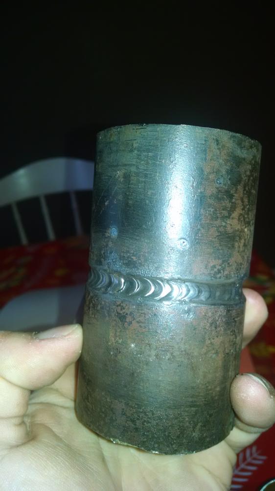

I'm posting updates here to ask for advice and so that I can keep notes for myself as well.
Got my first ever pipe root made. Same pipe I mentioned in the last post. I need to make a testing stand.
I beveled it out with about a 1/16" gap. I think that's 1.6mm for our metric-minded friends. Wasn't perfect fit up, and about a 3/32" land, which was entirely too much. Just under half the material thickness.
Ran at 85A, which was too cold for that size land. The root got decent penetration, but no reinforcement, I'm sure it wouldn't pass any legitimate test.
I'm including pictures for anyone interested, logging my progress.
I need some hand steadiness exercises, this was done free hand, with no props, and I never knew I was this shaky lol.
My next fit up will have more effort put into keeping the pipes aligned better. My land on these is about 1/32", and I will keep the gap about 1/16". Maybe bump the amps to 95, we shall see.
I see why everyone suggested bigger pipe, this small stuff went pretty quick with not a lot of time for paying attention to angles and such, so I will see if I can scrounge up enough dough for 4-5' of 5 or 6 inch pipe. Probably somewhere around $20-30 from the scrap yard.
It looks like this stuff will take about three passes to finish out once I get my root to lay in good. I still have about 8'4" of this pipe left, so plenty of 2" coupons
I hope to run at least one pass every night after work. Gonna cut bunches and bunches of coupons here, maybe even work on some stick pipe! This is exciting.
