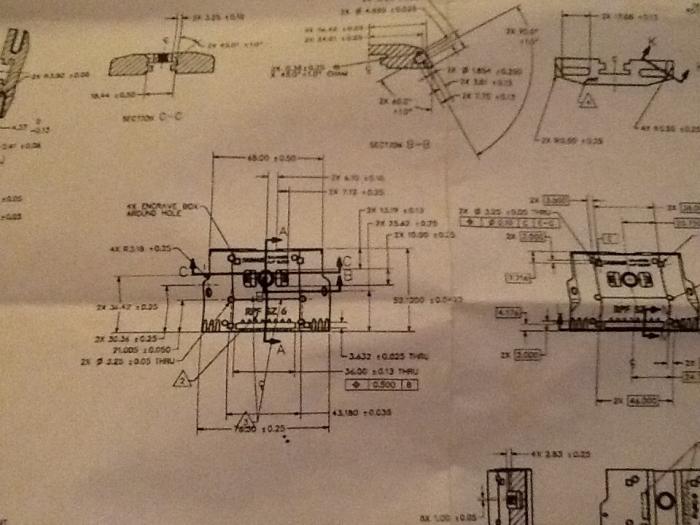

For comparison this is a a real print from some parts on the CNC side
- image.jpg (50.73 KiB) Viewed 1426 times
Kurt,
This IS getting really sketchy.
These are NOT standard symbols. I have a folder full of them, and this bullshit does not appear.
I'd almost suggest it's a "stitch" pattern (2 inches weld, three inches not [also not a standard way to designate a stitch weld]), but it cannot be since the symbols says, "weld 100%" (the circle where the arrow turns). It can't possibly mean a differential in leg length as your boss seems to suggest, since no units are given and it's pictured as a groove weld where leg-length does not apply.
It's time to get the dick who wrote that to stand up and explain himself, because (as others have said) if it's not a "signed off on" revision documented on the print, it's some asshole's note and has no useful meaning to anyone but him.
