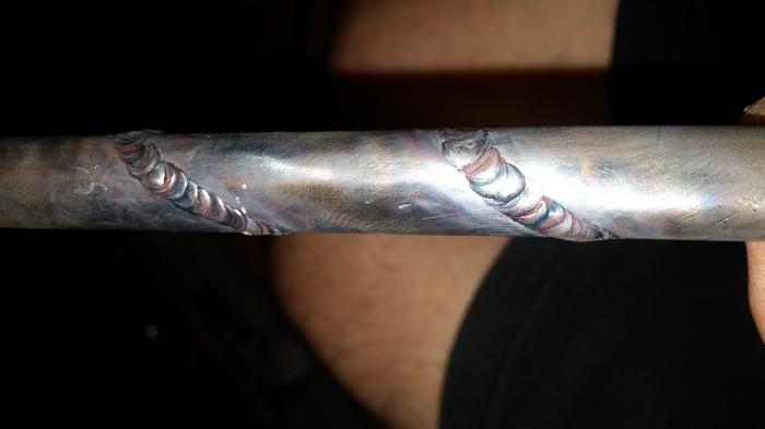

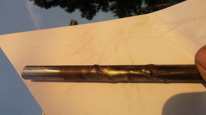

OK Made all of the pieces for the repair job. I welded up a couple test parts just like the joints to be repaired. I thought I would blow off the end of the tube where it feathers down to nothing on the ends...and it did to some extent. The welds are not as pretty as I would like...but function is important and not burning up the tube. I think the test came out OK. The inner sleeve wound up being .042" wall inside the .035" wall new replacement tubing. Gap was right at .123" wide after tacking up. Had to keep somewhat of a big plume near the feathered edges of the tubes to try and get it with one pass. Using .045" filler helped a lot, but probably has a lot of push through. No undercut and all wetted out decent. I did let it cool between each 1/4 of the weld, but didn't get enough filler in spots near the tube ends where it melted away. You think this test is good enough results to go ahead with the repair?
