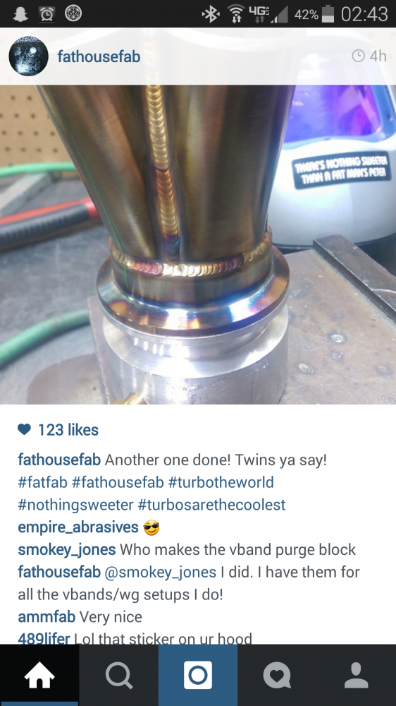

Have you ever thought about machining a flange out of aluminum? It would be fairly easy with a lathe. A friend of mine has quite a few turned in different sizes for the ones he welds and he just clamps the assembly on there and then has a little brace underneath to hold the collector level while he welds it.

- uploadfromtaptalk1423813466516.png (554.62 KiB) Viewed 6094 times

That's a good idea for me to produce! I just need to learn how to use my new Lathe/Mill/Drill machineGreinTime wrote:Have you ever thought about machining a flange out of aluminum? It would be fairly easy with a lathe. A friend of mine has quite a few turned in different sizes for the ones he welds and he just clamps the assembly on there and then has a little brace underneath to hold the collector level while he welds it.
Or use your new fancy Street or Strip Concept back purge kit!!GreinTime wrote:The one pictured above has a 1/8npt barb in it for purging as well, then you would only have to put foil over the ends or whatever.

Well yeah, I would you clown lol. I don't have any of the flanges turned to v-bands, although I could probably use the lathe at the school pretty easily to make some.
