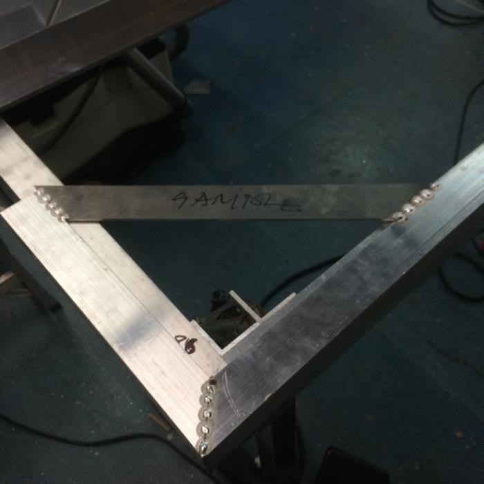

Here are some pics of a sample I TIG'd up today. I think I am going to pull the trigger on this next week.
it came out pretty durn square, after a few prototypes. I've done a few at this point, and think I've got my tacking order such that it comes out square and not obtuse or acute. I would be very curious if anyone has any recs about the order in which they would tack this up. I found that if I start on the vertical outside corner, it ends up obtuse, so I'm starting on the horizontal top section toward the outside corner, then the vertical outside corner, then the underside.
200A, 60% penetration, 4043 filler, 3/32" lanthanated electrode. I found that 5053 filler has a tendency to crack more. My imagination?
I cut my vertical bevels on the chop saw, and am grinding my horizontal bevels by hand with a wheel. I don't like the burr it leaves though/ flap disc? Or clean up with file...

I would use 4043 for the reason you stated, cracks less.
For bevels on Aluminum I use a trim router, I finally found a 30* chamfer bit for it, I used to use a 45* bit. It's very fast and clean. The chips go everywhere so wear glasses and plan on a mess.
