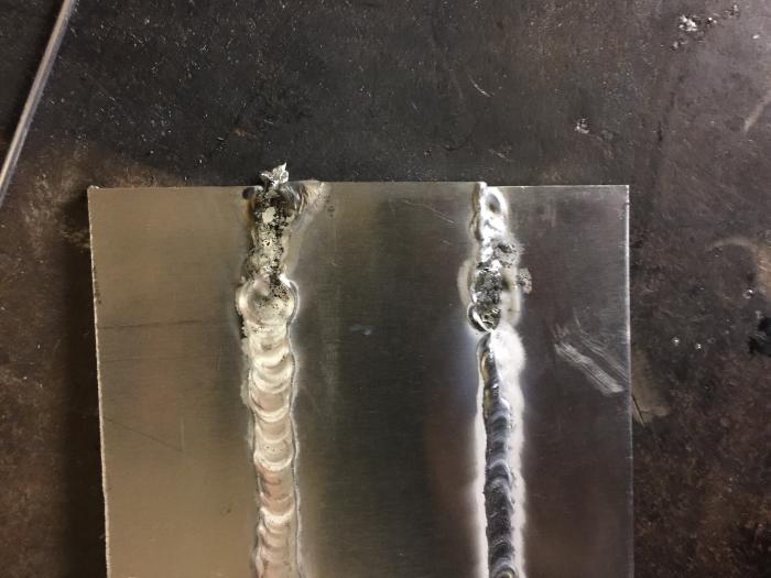

What causes this
Everlast 210 ext.
setup
130 amps
Ac balance 30
Ac frequency (hz) 120
30 scfh argon
Artie F. Emm
- Artie F. Emm
I'm wondering if your argon flow rate is too high. The Miller welding calculator,
http://www.millerwelds.com/resources/ca ... ulator.php
suggests 17 cfh. I'm not sure that will solve the problem but it will make your bottle last longer.
