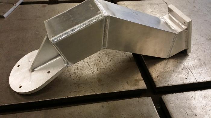

Depending on how big the 3/8 plate is in size your defiantly lacking in amps . If your welding close to the edge of the plate you may just about get it done , but if it's a large piece of material and your near the centre is going to take all the heat out of it..
This is a job i welded a couple of weeks ago , 6082 T6 ....5/8 plate with some 1/2 plate and 4x4 x1/4 wall box....Done with a Murex 350is set at 210 amps using 50/50 Argon/Helium with a 2% Lanthanated tungsten and pre-heat..
The biggest issue i had with this was the 1/2 plate , which is the radius ended part , had been cut out on a water jet and left the cutting media imbedded in it...After lots of cleaning with an orbital sander and SS wire wool and brush it cleaned up reasonably well , but still not as clean as i would have liked..
If i'm welding large thick section aluminium i sit it on aluminium box section spacers to keep it off the large steel bench that you can see in the photo's , that thing just sucks all the heat out of the material..

Thanks for your response. I did elevate the aluminum off of the welding table with small spacers so that the welding table wouldn't suck the heat out of the aluminum plate. I was welding in the center of the plate, so it was taking a HUGE amount of heat/power to get things welding. I think my SW 175 just doesn't have enough power to weld 3/8" aluminum plate. My welds turned out to be about an 1/2" wide after trying to heat the aluminum with the TIG torch. And the black crap floating in the weld puddle was nasty. And my arc was wondering all over the place too. When I watch Jody weld, his arc is just so stable!
I am thinking my machine just doesn't have enough horse power to make it happen. I don't know what else to do, since I used a mixed gas, lots of preheat (soaked the aluminum for 35 minutes in the BBQ at 350. The only thing I didn't do was use DCEN instead of AC, maybe that would have helped too, I don't know.
The Miller Dynasty is running almost $9000.00 when set up to weld, CRAZY! :shock: I just hate NOT having the right equipment to do the job! :x

BTW, your welding looks really good on that aluminum!!! :D Nice work!
