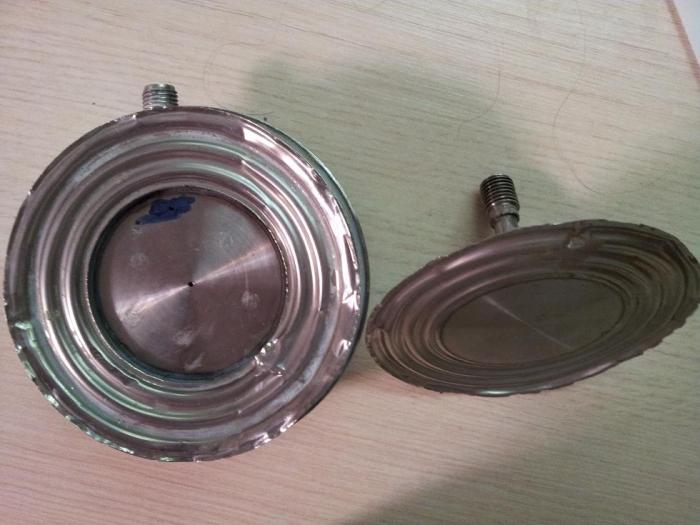

I am a new bee in welding and trying to learn and make a stainless steel bellows. It contains 4 circular 0.2 mm thick and 15 cm diameter with a circular 5 cm diameter cut (hole) at the centre. These sheet have to be edge welded from outside and inside to make a circular bellows and has to be 10^-8 mbar vacuum tight. Anyone can suggest what type of machine (Tig? AC/DC? Pulse? frequency? ...) is the best for this purpose?
- top sheet dismantled
- p5.JPG (46.18 KiB) Viewed 4070 times
- Stailess steel bellows
- p4.JPG (34.51 KiB) Viewed 4070 times

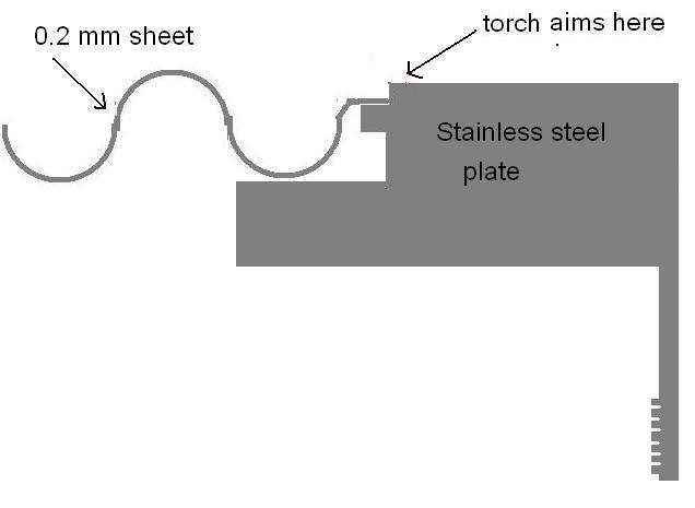

Close inspection indicates welder used the attached trick not to let 0.2 mm sheet to melt. Actually torch aims at the steel plate and the melt flow towards 0.2 mm sheet and welding take place. This way I think I need a much higher amperage to melt the steel plate. right?

On the drawing you show where the torch aims but not where the intended weld join is. Could you highlight that too?Agoo wrote:Close inspection indicates welder used the attached trick not to let 0.2 mm sheet to melt. Actually torch aims at the steel plate and the melt flow towards 0.2 mm sheet and welding take place. This way I think I need a much higher amperage to melt the steel plate. right?
Frankly I'm not confident with that approach. I don't know how you'll get the necessary precision focus of the arc.
Your updated drawing will help me understand.

This is how it is in the original welding. I meant torch should not aim at the 0.2 mm sheet otherwise it may melt. Right?
I haven't done even a single weld yet but this much I understand from what I have learned so far from close inspection of the original part. Most people I talked to they said this weld in impossible or very difficult and it needs fixture which will cost lot more than the cost of the welding itself. I want to have expert opinion here where or not this weld could be done manually without fixture?
It needs to be vacuum (10^-8 mbar) tight not look nice or whatever.
From what I saw from videos it shouldn't be that difficult and it is possible as far as I use low amperage, AC machine and proper tungsten wire and proper lens. Right? I need as much advice as possible and need to see videos close to my case.

Does that mean you are going to TIG weld the 0.2mm (0.008") stainless to the stainless steel plate, with relevant sizes similar to what is shown in the drawing?Agoo wrote:This is how it is in the original welding.
Are you sure it's a TIG Weld, and not perhaps something like Silver Soldering / sweating the two parts together?
I actually missed part of the razor blades in the picture I took, 5 amps blew away some material until I could get moving.
If your wanting to weld that thin material to thicker material, and it being stainless, I'd say mock up the joint and practice alot!
I may have overlooked it but how thick is the material that the .2mm sheet is going to be welded/fused to?
You definitely will have to point the tig torch toward the thicker material. Depending on the thickness, that may be a easier weld than it sounds like at first.

I understand. Sure I will need a lot of practicing before I can get any reasonable welding. In the future I will need this sort of welding a lot so I thought probably that is a good idea to learn and practice this myself.
Plate I intend to solder the 0.2 mm sheet is about 1 cm thick. I have two method in my mind (attached photo). Method at the left and method at the right. Both is possible. It remains which is better and easier? Please let me know which one you prefer to do and why.

30+ years ago, I was the engineer on a project requiring a similar configuration bellows for a high hermeticity (low leak rate) weld. We ended up successfully producing parts with an autogenous electron beam weld similar to the config shown by Agoo on the left of his post of Thu Sep 25, 2014 11:17 am. Our config was an approx.2.5 inch diameter bellows edge that was level with the top surface of the plate & as near to zero radial clearance as we could manage. I recall the bellows was about 0.3 mm thick, EDM'd to final dimension from solid Kovar plate (low thermal coefficient of expansion iron-nickel-cobalt alloy). The piece it was welded to was also Kovar.
Our successful leak rates (not every try succeeded, but pass rate was 75% or better) were in the range of 10-8 atmospheric-cc/sec Helium.
I, too, will be very interested to see how Agoo proceeds & what results he achieves.

Actually, I find Agoo's drawing very workable.
I've not tried this as an "original build", but only as a repair, where that excess metal is already used up. The idea of fusing a built-up ring to the .02mm makes perfect sense.
However, I'd have my torch angle at 90*, or even pointed back to the heavy material, focused .08mm to 1.0mm away from the edge of the 0.2 material, and allow the puddle to trail my arc and make the fusion. I've done this on somewhat thicker material with good success.
