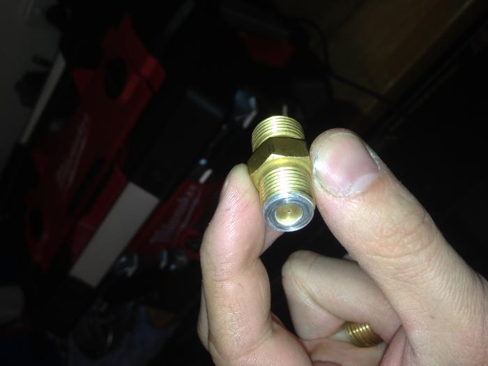

NOW....... I've noticed on the side of my reg there is a hex block off(which you can see I've removed in the pic) so i thought i would buy a adaptor like below, screw it into the red and run my bobbin off that, so i went back to the shop, explained this, and he scratched his head, said i should have got fittings with the bobbin and gave me a second hand one (pictured)
I went home only to realise he screwed me and the thread was different FML. I had to go to my gas supplier today and went through this whole process again and he said i should never use the outlet that i had unscrewed the block off from and that i should use a Y piece and run two bobbins from one outlet to purge...... only catch is that he wants to charge me $70 for a freakin Y piece.... no thanks.
What do i / should i do?

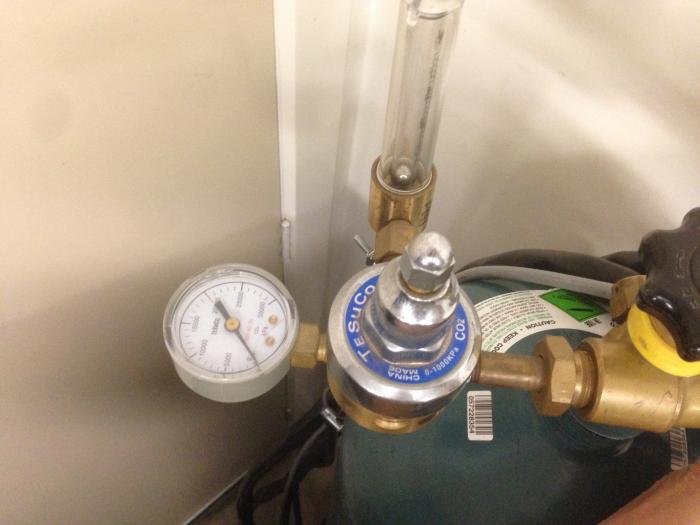

I am sure most of us here can help. I agree with Len, do not do anything until we see pics. I (as well as others) have experience with back purge and the necessary fittings needed to get there. Please post up so we can help.
sorry guys my bad, for some reason my pics failed to upload.

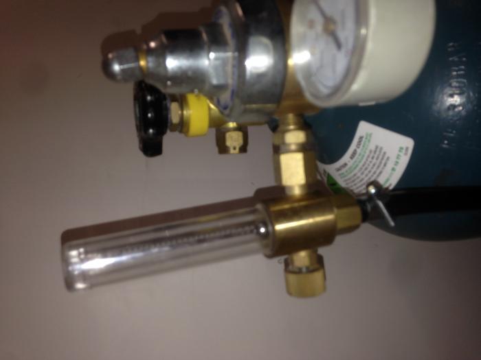

heres some better pics
Im at a loss as to what to do as I'm hoping to get it up and running by tomorrow so i can get welding over the weekend.

also i forgot to mention, i have a barbed fitting to go on the outlet of the flow valve......can i just use some cheap rubber hose and tape off the ends of the pipe or would you guys recommend something else

I can't really tell by the picture but if you crack open the valve at the cylinder without anything in that open port you should be able to tell if it's on the low pressure side by the volume of Argon that comes out. The low pressure side of most Argon regulators are usually less than 75# of pressure, that will be easy to distinguish from the tank pressure. If it's on the high pressure side it will scream out of there so keep to the side of it.
As to the hose question, I use old Argon hose that has been cut and is no longer used for the torch, but you can use any clean hose or tubing that you have. Smaller is better in this case so you're not wasting Argon. Make sure it's clean inside, old compressed air line is a bad choice because it usually has oil in it and our goal is to keep contaminants out, not add them.

As per usual, I'm more confused now than when i started this whole ordeal!!!!!
Im starting to think my local supplier is a douche bag.... As i said earlier i walked in and said that i wanted to back purge some pipe and to give me what i needed to do the job, at which point i was sold a flow valve and said thats all i would need plus some hose. $70 bucks i think i got bent over for that day
After getting home and scratching my head as to where to stick this thing.....I went to another supplier who said "nahh all you need is a "y-piece, $70 bucks thanks" i nearly fainted and said no thanks surely theres a cheaper way to do this.
Now i went back to supplier #1 who sold me the flow valve, this time i had enough and unscrewed my reg and the whole shebang and took it with me, dumped it on there bench and said "make it work"
This time, the same guy who served me and sold me the flow valve said " Oh I've never ran two flow valves off a reg, i would just do it like this.....(see pics below)
At this point, two more "professionals" had wandered over and i failed to see the irony in the fact that he was contradicting himself and had sold me a freaking flow valve only to tell me i didn't need it after i spent a week losing my Sh1t trying to figure out how to make this whole thing work, i was a bit under pressure with people standing around and didn't stand up for myself (i thought of all this after i left the store so i only have my pea brain to blame.
SO
My question is....like i told the guy behind the counter, with me tapping into the gas flow after its been metered by the flow valve, am i not robbing my tig torch of argon? there answer was no you only using a little bit of gas for back purge..... at which point i politely said, " well then am i not robbing it of a little gas then?" to which they said " oh it won't make a difference.....

What you have pictured will work, but yes it's robbing your torch of Argon. I've used that exact set up a few times when I didn't have a choice. Only open the valve to your purge line as much as needed to maintain your purge and up your flow about 10 CFH from what you would normally have it set at. It's not the ideal set up but not many things in life are ideal.
Like I said earlier, if you're going to weld Stainless a lot, buy a dual flow meter and be done with it. I have the luxury at work of having someone else pay for Argon so I just use 2 cylinders with their own regulators, but at home I make due with what I have, which is what you have pictured.
