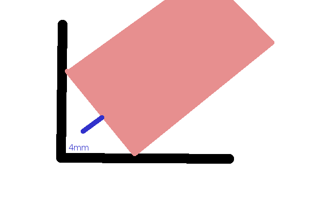

Just out of interest when you are doing fillets do you use a bigger cup and rest it on the material so you have a consistent arc length (see quick diagram attached) or do you prop the cup away from the corner? I wondered whether my cup is too close and the argon is too turbulent at the weld site? I know I am grasping at straws here?
- cup to close in fillets??

I don't like to rest the cup on aluminum since it's so soft it tends to drag on the cup.
I normally run a #8 cup with standard collet body, #7 with a gas lens. Stick out enough to hold correct arc length without resting the cup on anything.

As for the last question posted, I prefer a smaller cup and propping away from the weld for aluminum. Again, personal preference, though, as either can work if you're comfortable with it.
The closer the cup is to the weld, the more gas flow can become an issue, so adjust accordingly.

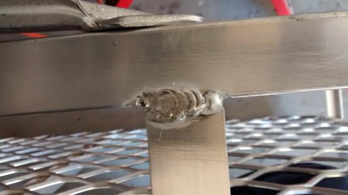

I thought I would update people as to what I have found while experimenting with this problem. Please note this may not work for you but I hope some of it helps if you have similar problems.
Note 1: the original problem was that although other welds worked fine I was having a big problem with Aluminium fillet welds with 25x25x3mm brackets to 35x25x3mm box: as I put the filler rod towards the weld a blob of molten Al would blow off the end of the filler rod long before I got anywhere the actual joint or weld pool. Setup was as follows:
Initial Machine settings:
Peak 160A/Trough 40A
Pulsed at 1Hz with 70% @ peak : 30% @ trough
AC Freq 120Hz
Electrode Balance set to 90:10 (-ve:+ve)
Pre/Post Flow 1/6sec
2.4mm Zirconated rod, tapered
Note 2: I could weld the joint autogenically (i.e. no filler rod) quite nicely but of course strength is the issue with that.
Solutions found:
1: Way too much gas! I assume that because this is in a corner with the cup pointed towards the rod that you need much less gas and hot plasma was hitting the rod well before it got near the pool. I experimented and found that if I dabbed the rod in very quickly at a very low angle i.e. sneaking in along the the corner and quickly dabbing at the very edge of the weld it would work better but this was too unpredictable and too error prone to make it useful. However once I played with the settings and reduced the gas down to <7 l/min this seemed to allow me to get closer with the rod before it melted.
2: Way too much -ve balance. I assumed that as I had new clean Aluminium which I had brushed and acetoned I could safely use almost no cleaning action: RIGHT and WRONG! With autogenic welding with no oxide it worked fine but as soon as the rod "blobbed" it picked up oxide and with no cleaning action the weld wet to crap form then on! So if I used filler rod then I set the balance back to 70:30 or even 65:35. This allowed me to stuff up without dirtying the weld!
3: Pulsing! For me pulsing seems to work when I have a good flat position and can move from beginning to end in a smooth motion without stopping. However many of these joints were in non ideal positions so I turned off pulsing and immediately had better results. However I was having some problems getting to hot so I set the "down slope" to about 2 seconds and used the trigger to control my own pulsing: if I thought the pool was too hot or I needed to reposition release the trigger readjust/cool and then pull the trigger again.
4: I had originally been using 2.4mm filler rods but you need to use a bigger filler rod! Using a 3.2mm rod worked much better and I could sort of just dab the rod in and not have to push it in to get enough filler material.
However I still did not get the results I was after so I resorted to cheating!
5: In the end I got the best results by doing a quick 3 pass run yeah I know time consuming but it gave the best results:
Pass 1: autogenic pass: just weld the two surfaces together
Pass 2: lay filler rod into the corner and run the torch reasonably quickly along the joint to melt the rod into the joint
Pass 3: go back over the weld using the "manual pulsing" to really weld to fillet together being careful not to get it all too hot as the whole thing can just collapse. In fact you can even do this 3rd pass much later after doing all the 1/2 passes.
PS: A warning for those who use acetone; I was wiping the rods and material with a acetone soaked cloth and during the process of wetting the cloth managed to soak my glove in it! Now good sense should tell you don't start welding until your glove has dried out .... well as I started welding the remaining acetone caught fire in my glove and it started to get hotter and hotter but with the helmet on I could not see the flame .... and then it got very very hot .....I think theres a lesson in there somewhere!

- Braehill
Iced,
Isn't amazing how good hot gloves are at teaching, and usually in a single lesson. My kids will tell you that my favorite saying is 'Stupid's supposed to hurt, it keeps you from doing it again".
There's no such thing as cheating when it comes to welding, if it works, it's all good. The welds look much better. Glad you figured it out.
