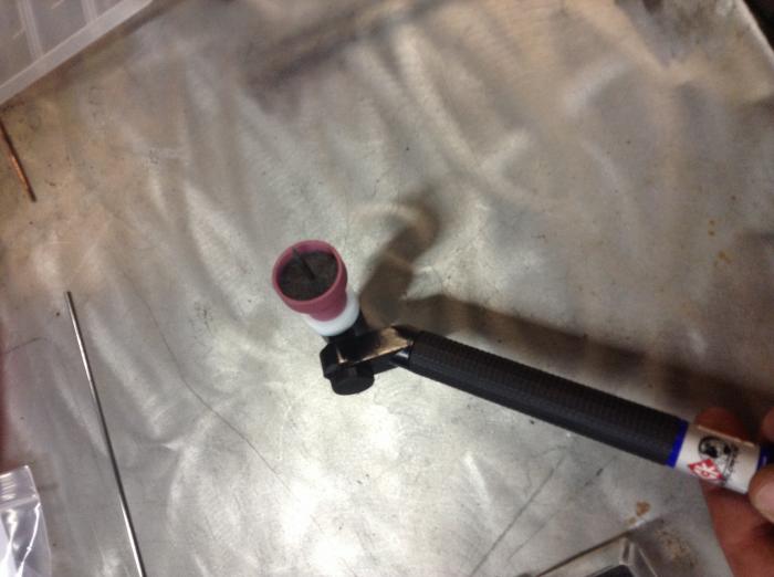

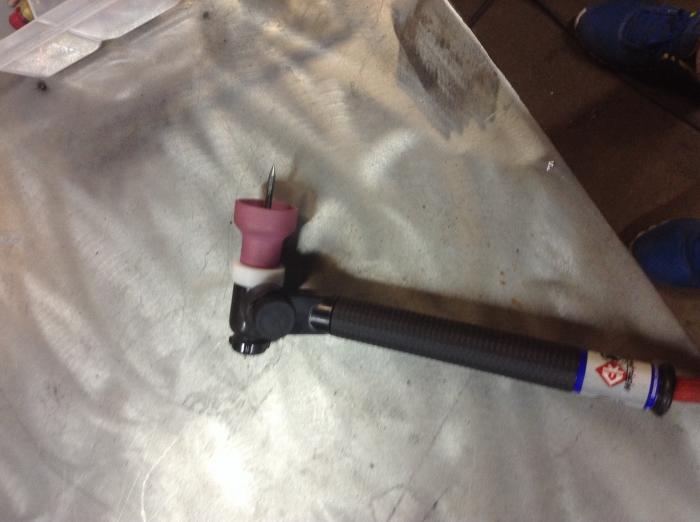

I got my monster tig cup today I think it's a #16 so far I like it but I wanted to let anyone that's planing on getting it not to buy the defuser biscuits they sale for it. Just get you some scotch-brite pads and cut it from that. I'm pretty sure that's what they do. I mean it's even got some white lettering on them just like the scotch-brite pads just saying they look the same. You could also use screen they both work good. Whatever's easiest for you and your situation.
- Monster tig cup on a CK FLEX LOC with the 3 series head on it.
- image.jpg (37.02 KiB) Viewed 1484 times
- image.jpg (35.5 KiB) Viewed 1484 times

Always wondered how the scotchbrite doesn't burn or melt....? Maybe its just not as hot in the cup as one would think?
