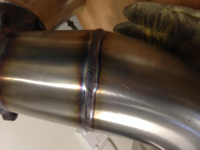

If i may, i would like to post up my latest job, a Stainless 304 exhaust pipe and maybe get people to critic it- who knows you guys might look at it and see something obvious
its 16guage 4" 304 stainless, I'm using 316 filler(i think its 316-but its what the welding supplier said to use)
i run about 65amps on the high side and 20 amps on the low setting, i have about 3 seconds of post flow of pure argon
i chose not to back purge after taking the welding suppliers advise although i now wish i did as there is a little bit of sugar protruding inside the pipe.
I clean each section before welding with acetone
Am i correct in thinking a major part if my problem is the fact that in some sections i could not get the pipe to butt up perfectly so there was sometime a couple inches of perfectly butted pipe that i just fused with no filler rod and then i would get to bits that required roller rod to not only weld but sometimes even fill a 2mm gap between pipe?

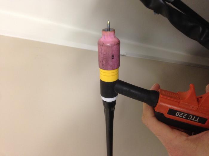

is that cup right for the application? i don't really understand when and where to change cups and collars

- this is the torch set up, sorry i don't know the terminology of cup sizes etc. but the electrode had a red/maroon coloured tip on the end, i use maroon for steel and white tipped electrodes for alloy

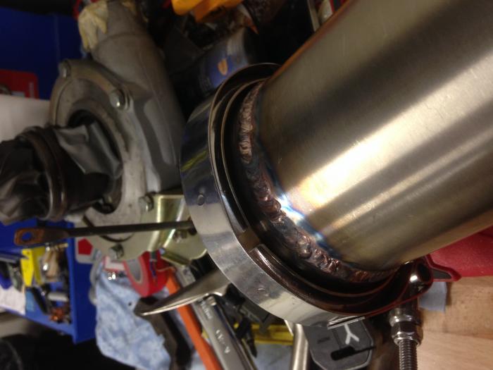

- flange is mild steel, i could i had to really turn the amps up to pool the mild steel(85amps) and the arc seemed to wander especially close to the bolt holes....how do i get the arch to not wander?
- photo 2.JPG (24.81 KiB) Viewed 4406 times
- this was a lap joint, if thats what you would call it because there was a outer sleeve welded to the inner pipe, i found that if i got a pool going on the pipe as soon as i pulled the arc over to the flange it would very easily melt the flange, i assume because there is less material on the flange and it absorbs the heat much faster?

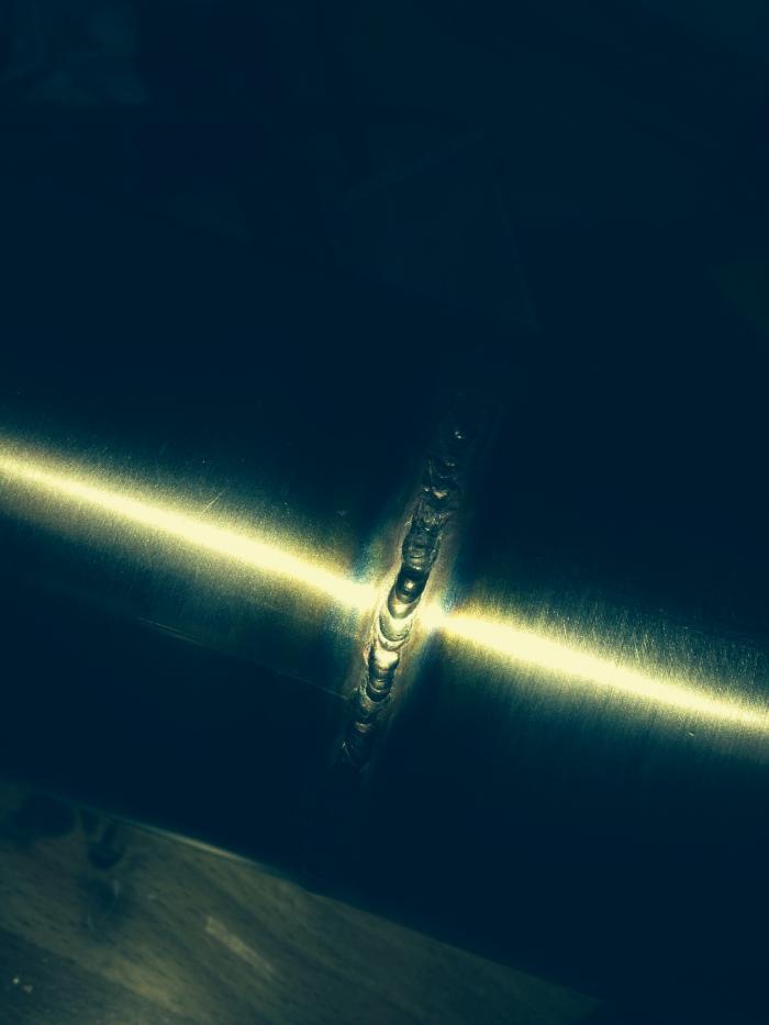

this is the finished part, as they say, good from far but far from good.
excuse the calendar its the only pic i had at the moment
like i said feel free to hurl abuse at me, any suggestions appreciated

as you are welding 304 with the odd mild steel flange surely 309 is the obvious filler - because you have the heat set for autogenous welds adding filler will create a cooling effect & give a large build up unless it's very small diameter - so get the smallest rod you can find.
I admit the size of the exhaust would be costly as a hobbyist to back purge so maybe take others advise on if solar flux type B is a suitable substitute to that.
Fit up is everything for an autogenous weld so take the time to make it as perfect as you can - don't rush the prep - this makes or breaks the overall appearance when complete
If build in sections in 4" consider if it's possible to clamp a backing block of copper inside to help with heat - if not then try welding in small runs & allow to cool before continuing
Consider using a Tig finger or other device to prop on the tube to achieve the shortest possible consistent arc gap without contamination - I have seen a roller guide intended for a plasma torch modified to fit a Tig torch to achieve this on larger pipe
Pulse can help - but only if you can set it up effectively - have you tried Jodies rule of 33 ( I can't as the machine is retarded & only goes to like 10PPS )
Consider a few hours practice before attempting an actual job - stainless in that thickness is quite tricky - heat builds so quickly so you need to have your eye / hand control sorted & the machine set right.
The No.6 cup your using is fine - unless the bulk of the torch won't somewhere that covers most jobs - the more cover the better on stainless so a No. 7 or 8 would be great - I tend to leave a gas lens 7 or 8 on all the time - only exception is cluster joints or other limited access jobs.

I appears that you're already using a gas lens by the shape of your cup. I would bump up to at least an eight or ten (cup sizes are in 1/16 of an inch i.e. 8/16-10/16) cup for stainless. That way you can use up to about an inch of stick out without worry. Brian's right about using 309 rod on the flange if it's carbon steel, it's best for dissimilar metals.
Fit up is very important but it will not stop the sugaring. A back purge or Solar B flux will stop it but there are plenty of so called professional exhaust systems out there that are not back purged.
Face time is the only thing that makes consistent sized welds. Practice on your scraps so you learn what works for the type of material you're using. Thin filler rod (.045 -1/16) should be all you need and try and time when you add filler so your weld bead remains consistent. You're on the right track, you just need practice.

I hate it when people post pictures of welds like that - it makes me feel slightly inadequate ! - I bet you do more than the odd 30mins of Tig weld a month ! I should'nt be jealous or blame 50 year old eyesight - Grrrrr !
You see. The thing I don't understand is on that picture you posted above, you can clearly see how you have started and stopped, but it's still very uniform, how does that happen? Obviously once you stop the material cools and wen you start again it changes again..... Yet how is there a uniform puddle and even heat marks?

A #6 cup can be used to successfully weld stainless, but if I were you, I'd be using a MUCH larger gas lens setup. Minimum of #12 with about 15-25 CFH of argon flow if you can manage a relatively short stickout yet maintain a much greater coverage area for the argon to protect the bead from gray'ing out on you. Welding tube is inherently more difficult to control gas coverage because the surface curves away from the cup at all times, and the argon has no chance of naturally lingering around to help protect the red-hot weld bead before the atmosphere makes its way to it. It helps cover up my lack of technique that's for sure! I'm getting better each time, but the gas lens and large cup help make up for some of it. Who cares where the improvement comes from; if it's there I'll take it! Also 3 seconds of post flow is no where near sufficient for stainless, especially with round tubing because the argon leaves as soon as it exits the cup---has no where to get trapped to displace the evil air that is awaiting with oxygen to dull your weld. Think more like 8-12 seconds---maybe even longer. Try it. You'll like the difference. Yes it costs a lot of gas to help get good color if you are not actively pulling the heat out of the joint with other means. It's part of the game.

Gas lens vs standard collet bodies/cups: always use a gas lens if the situation permits. Once you can manage a very short tungten stick-out, you can drop the argon flow VERY low to really save some argon.ONDGAS wrote:thanks for your time and reply Oscar and GreinTime,
how do you guys determine what size cup/lens to use and when to use a gas lens and when not?
Am i right in thinking its best to use the biggest gas lens possible given the room?
when is big too big?
gas lens cup size: for stainless use as big as you need to prevent oxidation (gray'ing/dull'ing) of the bead surface as much as possible. For me even with a jumbo gas lens, I can still only manage to get pinkish/goldish tint at the weld bead, as I have not yet perfected my technique to manage all golden straw color which would be ideal. Once you can manage an acceptable level of "color" with a large lens, then drop down a size and see if you can better your technique to get the same result with the lower flow rate that normally accompanies the use of a smaller cup size.
