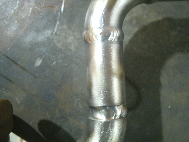

Here's a sample of welds done each hand... It was rollouts on the bench, so I "could" have swapped around and done them all right-hand. It was faster and more convenient to just switch hands, but looking at the image, I might do more of this stuff "southpaw" :o ...
You'll notice in both the cap (top weld) and fill (lower weld), the left looks better. I suppose this is because I still have to focus a bit more when the torch is in my left hand, where the right has become automatic...
