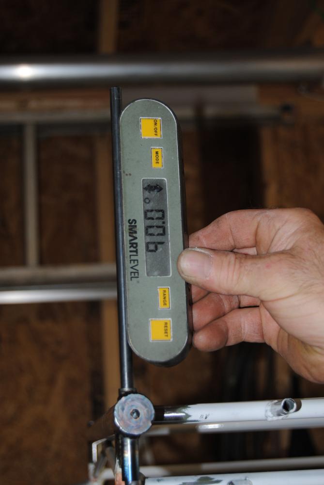

Here is a pic of the rear wing attach tube that was out of square and too close to the front tube as far as being correct for wing spar placement. It has bolt on wing spars....the bolt centerlines had to be as close to the lift strut bolt center line as humanly possible. I welded the tube as an assembly on the table then to the fuselage. Both side are 90 deg. true with respect of everything else. Bolt through tube is 7/16" x .078" wall and the main tube is 1" x .035" wall. Machine set to 125 amps. Thanks to all here who have helped more than anything it was no problems. Tacked up several places and took a couple of evenings to get things where they needed to be and a no gap fit up. It did not clock on me...that was my biggest fear. I guess with my learning the foot pedal I like some overhead power to get a puddle faster and back off to carry on. It helps me to keep from putting so much heat on the thin tube. But that is just my strange way. Super tight fit up really helps with different thickness tube....I mean reamer in the mill kind of fit. I found I can run a nice tight bead with no worry of blowing out. Helped me anyway... learning to fit parts tight and clean everything 3 times.
