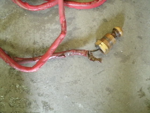

I was welding in the 250-300 amp range on a wc torch (HFAC), and accidentally pinched the supply water line under the wheel of my creeper. In less than 30 seconds, I had this on the return/power line:
And a shop full of smoke.
Note the size of the power wire, on a torch rated for 250A continuous.
- GEDC1031.JPG (183.86 KiB) Viewed 1666 times

True enough, John,
But it's a cautionary tale. It shows the small size of the power lead, and the damage that can be done should the standing water in the line begin to boil, or should it drain back and be replaced by air. I would be uncomfortable welding even low amps with the cooler off, and would have to stop and feel the return line often (at least at first) to be sure I wasn't about to cost myself money. Remember, this was less than 30 seconds (perhaps much less, I have no way to know for sure) on a 250A torch. I don't know what 3 minutes at 30A would do on, say, a 150A torch or a 90A microtorch.
I'm not sure I can come up with a good reason to have three hoses hanging off my wrist and not turn on the cooler to use them all. I have heard tales of very loud coolers, but I think I'd prefer to find a way to quiet the system if I found it too annoying while welding.

In AC it is even more critical, as you have found out. Since the torch-side of the electrical arc gets much hotter than straight polarity, I can see how that wire would easily get hot enough to boil out the water.Otto Nobedder wrote:I was welding in the 250-300 amp range on a wc torch (HFAC), and accidentally pinched the supply water line under the wheel of my creeper. In less than 30 seconds, I had this on the return/power line:GEDC1031.JPGAnd a shop full of smoke.
