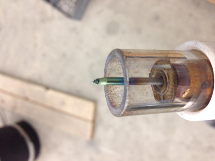

I'm welding on 6061 tubing with 4043 rod and my 2% lanthanated 3/32 tungsten isn't cooperating. The tungstens are new from htp usa. I have there invertig 221 with amps at 180 max frq 150 and balance 65%. Any ideas what causes this? Gas rate is at 18cfm
- image.jpg (27.13 KiB) Viewed 3444 times

Your problem could be related to a small amount of moisture in your gas. Jody made a video on the problem a while back.

I noticed that your tungsten is heat-discolored. It is too hot when the argon stops flowing on the post-flow. If the settings you are using you "must use", then you need to up your post flow time. Otherwise, you could try playing around with the settings to reduce the heat input into the tungsten. Everything you stop welding, after the post flow ends, your tungsten should look darn near the same way you started (of course except for the fact that will have a tiny little ball at the tip most of the time).

I've got the post flow set at 6.5 second and preflow at .5. On steel the tungstens don't split.
Yesterday I actually watched the end of it split after a fresh sharpen with only welding for an 1" long
Is there a chance tungstens are bad from factory?

180 amps, even at 65%, may be "borderline" for an alloyed tungsten. I've run these settings with pure with no issues, but have no experience with the Lantanated, so this is, to an extent, speculation. I have splintered 3/32 thoriated at those settings, though.

Also keep in mind that the Invertig221 has a lot of settings. Perhaps you over-looked one. I know I have at times!
With an inverter style machine, the pure tungstens don't work well. As for the settings, I've got pulse off, foot petal with hf on, slope down at 1.5.
I've got a set to run 1/8" tungstens. I've got 1.5 lanthanated and the radnor e3. Both tungstens don't look any better

I'm strongly leaning toward the idea of moisture in your gas, then. This is far more common than you'd think, and the source of many topics here.

I am thinking it is a lack of shielding, leak in the gas line or it is to much amps for this size/quality of tungsten. I have never had this happen to my set up. To my knowledge I have never experienced the moisture in my gas tank, so I can't really advise on that.

I did notice lately that the Pyrex cup seems to be sitting a little loose lately. This is the only stubby set up I have at the moment and welding in tight corners. I'll try to get a stubby kit with the standard cups and try that. Thanks for all the info

I'm with Rake on this one, that looks like a balance problem to me and not moisture in the gas. The Lanthanated tungsten doesn't seem to splinter like other alloyed ones do, they seem to crystalize for lack of a better term. If I overheat them with my transformer welder they do that same thing. I'd say change your balance or go to a larger tungsten.
The other thing that I think could cause this is maybe insufficient gas flow during the weld and during post flow. The longer your stick out is the more important your post flow is. When you shutdown the weld the end of the tungsten is the first thing to be exposed to the atmosphere, keep that torch in place throughout your post flow to keep it in the Argon stream. The heated Argon is rising away from the base metal so you get a residual benefit from it driving out the cooler atmosphere around it and off your tungsten.
This is where I believe that there is a slight shortcoming to using a large gas lens. They offer great coverage for the weld but at the cost of concentrated cooling for your tungsten. If you're putting 20cfh of shielding gas through say a 1/2" pipe it will be denser than the same 20cfh going through a 1" pipe because of the restriction.

I did change out the gas saver kit and switched back to the standard alumina cup and seemed to clear up the tungsten wear. There was a post mentioned earlier about air being able to make it pass from the back side of the Pyrex cup. I'm guessing that is because of the o-ring wearing out on the collet body adapter. Would that problem continue if I decided to get the gas saver with alumina cups?

HI AKrider,
I think Len nailed it. The only thing I can add is you need your post flow set
to at least 10-12 seconds. For 3/32 to have enough time to cool.
I think you mentioned 6 seconds.
For the grainey tip try backing your AC frequency down to 120hz at 180amps.
I get the same thing at higher freq on longer welds. I back the freq down and
it is not as bad, unless you are welding in a pocket or inside corner.

I would absolutely agree that your screen can and will get clogged. How long it would take and welding on which materials is up to opinion and how much you weld said material. I have "clogged" a stubby gas lens and completely ruined a Pyrex cup brazing silicon bronze.rahtreelimbs wrote:Something to think about. A while ago I phone Lincoln Welding in Cleveland Ohio. I spoke to one of their teachers at their tech school. We chatted about diamond wheels for sharpening tungsten and also about the cleanliness of the aluminum puddle while welding. I told him that I was using a gas lens and he said that I shouldn't. If I recall correctly it had something to do with the screen getting clogged when welding aluminum...............doesn't happen with stainless or carbon steels.

Think of it this way, look at the walls in your shop or if you have access to the shop lights, look at the film that builds up there. The same will happen to the gas lens eventually.
In looking at the screen in the picture, it is possible that this could be a problem, but maybe not the whole problem.

18cfh isn't enough for that pyrex kit. Try 21 or 22cfh.
The 221 likes 65-70% so I'd say your balance is ok.
With the pyrex kit the stick out should be 5-6 times the diameter of the electrode. Those pyrex cups will melt at 500*. And if you have the balance too low that doesn't help either. Same melting temp for the orings.
If all else fails and it is moisture, do what I did. Install a filter such as the superdry in your gas hose. $9 for the filter and $5 at home depot for some barb fittings. I have yet to get a fuzzy or bearded tungsten and things weld much better.
