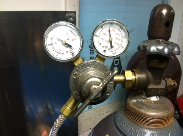

Hi all,
I'm hobbyist and very new to TIG welding - slowly getting the hang of it. Anyway, being the curious & perceptive person that I am, it hasn't taking me long to despise that "sspshuuuuuuuu" sound every time I hit the peddle. It's not the noise, rather the wasted argon I know that is happening. Doing my research, and as I suspected this doesn't just bug me, it's greatly identified in the community as initial "gas surge" due to operational designs between the welder & regulator and is considered a great source of wasted gas.
Background
Here's how I understand the issue :
The regulator (which is probably a cheapo) that came with my welder both reduces gas pressure to a manageable 50 psi and reduces flow to adjustable CFH via a needle valve. While welding, the psi in the gas supply hose (between reg & welder) is around 3-4 psi. However, when flow stops, the entire supply line slowly equalizes with that of the regulators design as gas continues past the needle, bring the hose up to a settled 40-50 psi. Thus, next time the peddle is hit, "sspshuuuuuuuu" the in-rush 50 psi is released as most of the gas surges out on preflow. I read as much a 7 times the supply hose's volume can be wasted each cycle. Yet understand this is actually somewhat desirable for MIG setups in keeping initial splatter away from the nozzle. Still, I'm not convinced there's an equal benefit for TIG.
Anyway, I'm a stickler on waste, so I'd like to hear some advice on how this can be mitigated. I'm sure some surge is wanted to help purge any O2 that may have crept up the nozzle, but crying out loud, I calculate this surge-phenomenon alone is wasting equal as much gas as I'm using.
I do have my setup on a cart, so I have minimized the length of my supply hose already. But as far as addition steps, I see that there are "better" quality or lower-pressure regs on the market that can get the flow-pressure down to 25 psi. I also saw a hose product (the GSS) which reduces hose-flex &total hose-volume considerably. Or has anyone invented or considered configuring the needle valve AFTER the welder (output)?
As I said, I'm a beginner here and thus I'm doing tons of start/stops, which is why this is a real problem.
Looking forward to hearing so thoughts & opinions on this subject - thanks !

You are correct on all accounts. There are some regulators/flowmeters that run at lower PSI. I believe some of the Victors run at 25 or 30 psi.
You've already trimmed your line from your flowmeter to your machine. That's the big offender. You'll have to think about whether the cost of a new regulator/flowmeter outweighs the loss of gas. If your machine has adjustable post-flow, tune that to be as short as possible to achieve your desired results but without any extra time.

Hi, Smitty.Smitty151 wrote:Anyway, I'm a stickler on waste, so I'd like to hear some advice on how this can be mitigated. I'm sure some surge is wanted to help purge any O2 that may have crept up the nozzle, but crying out loud, I calculate this surge-phenomenon alone is wasting equal as much gas as I'm using.
Great thread! I'm with you on the topic, and recently posted on plumbing my shop with hard line for a long run for this reason. In shops with a lot of stops and starts (e.g., schools), vastly more gas is wasted due to surge than used during welding.
What I don't understand is that the issue is fundamental - why is the flow regulator at the cylinder instead of the welder? As noted, eliminating the hose between the flow meter and the solenoid is the solution. Rigid hose would help - white poly 3/16" i.d. tubing doesn't expand much, though it'll still pressurize.

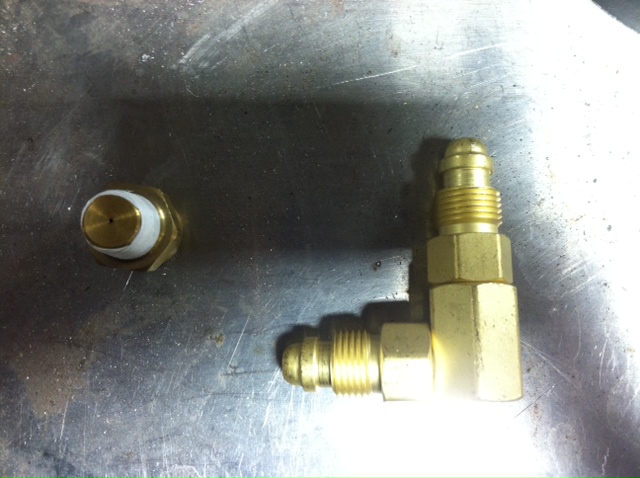

On the subject of adapters for the Argon outlet, most welders have a solenoid mounted inside the welder's case and the fitting just passes through the case. These solenoids are usually tapped for either 1/4 or 1/8 NPT and a standard street elbow could be put in place of the 90* adapter to 5/8-18 that is in place now and then place that fitting on the outbound side of the flow meter if it doesn't already have one.
As Rick9345 mentioned the solenoid valve also can be mounted anywhere in the system with the use of a pair of wires to supply the coil, tapped off your existing wires. You can buy these from places like Red Hat that are very generic, just in and out to very complex with restrictors and multiple outlets. That way you can leave your existing welder's solenoid and fittings un-molested in case you ever have to move it elsewhere and use it .

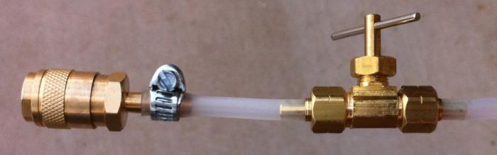

Just thought of something else that should be included in this new and improved system, a desiccant filter. Ok and while we're at it why not Swagelok quick connects. Damn you Smitty, now I need a part time job.
You know... A quick / cheap solution here would be to add a needle valve in the line right at the back of the welder.
http://www.homedepot.com/p/Watts-1-4-in ... /202254837
You'd need to adjust it to the max CFH you'd want, and it'd limit the in-rush.
You could use it as your primary CFH adjustment, if you can read the flow meter on the cylinder while adjusting it. (In which case you'd set the flow meter on the cylinder to wide open.)
Or, you could just adjust it to your peak CFH setting and keep using the one on the cylinder as your primary. (In which case, there would still be a surge, but at the peak CFH you set the new valve to.). This is basically what that commercial solution does - their hose limits the max CFH.
I'm off to the hardware store to give this a try!

Dang... this was a sinfully simple solution. No more gas surge - and this is a 25' line from my cylinder!
I opened the flow regulator all the way at my cylinder and adjusted the needle valve at the welder until the flow meter showed the right CFH. A small turn at the needle valve is easily 5 CFH - tighten the valve stem nut so it won't be easily changed on accident. (Or maybe, cut the stem short and grind a screwdriver slot in the end.)
No more "woosh" - just a nice steady stream.
For guys doing a lot of short welds, this should save a ton of argon!

Smitty,
Unlike the one you have pictured, there are a lot of flow meters that have the regulator and flow meter as two separate units, Smith being one I believe. I have a couple of each kind and my Harris is combined and one other that I don't recall who makes, but I have a couple that are separate. So I don't think the others are convoluted in their thinking, I think they might have units that are separate that's all.

This thread has been very interesting. I decided to see what I could come up with. I think if money in not the object, or if you were buying new anyway, I would go with a pressure regulator on the bottle and a flow meter at the machine. Because of this thread I will be taking a better look at my DC600's and possibly be making some changes on them. Both machines have LF-74 wire feeders that are mounted on a portable cart for use inside tanks. They each have 25' hoses and I'm sure waste a lot of gas.
NOTE: This was only a test. I do not have hose clamps on my barb fitting and this was tore down afterward. I will reconfigure later for use one of my TIG machines.
I decided to try something at home first and thought I would share the pictures and part #'s. This has already been mentioned, I think, but all I did was move the orifice down to the back of my MM 252. I used two identical Smith Regulators to try and eliminate differences. Running 25 CFH I deffinently noticed the surge went away entirely with the orifice on the back of the machine. I also did a balloon test on the end of my gun to check how much volume actually was used. I simply held the trigger for 5 seconds multiple times to see which would fill the balloon the most. I didn't notice a huge difference in size of the balloon, but it was there. I wish I had a Shield Gas Flow Tester to see how much of a surge was actually there with the "stock" regulator.
Parts used
Western AW-409
Western AW-15A
Western 541
Parts used
Western AW-409
Western AW-15A
Western 541
