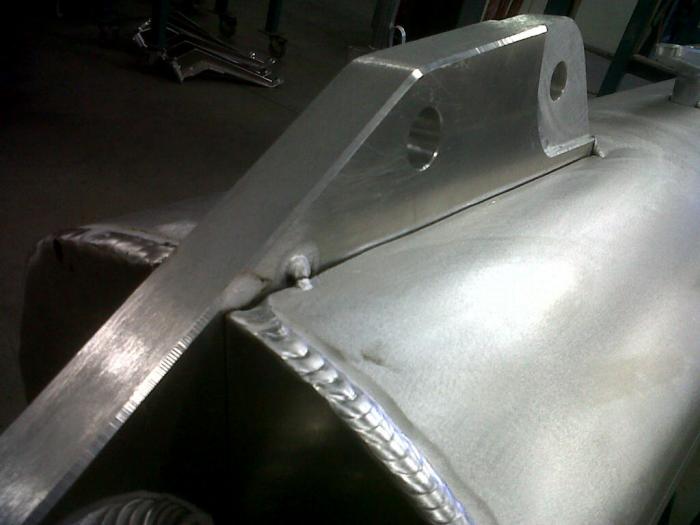

I am an artisan welder at Southern Spars South Africa. We manufacture yacht masts and supply the world.
Yes I definitely pre-heat the thick material, must admit I haven't post-heated. I am using 5356 filler rod. Cant use an oven either because masts and x-beams are somewhere between 5 and a 100 meters long. Some of the parts I have to weld is even thicker 50 to 70mm. We had a rep come to see us the other day and he recons on thick aluminum like that you have to use a tig pulse machine. As the rich people buy bigger yachts our material gets thicker and thicker. Even if I pre-heat it and weld it at about 320 amps my machine struggles to cope, if I put the amps higher the machine overheats an cuts out. I am scared that if we do buy a new machine that can pulse the problem might not be solved.

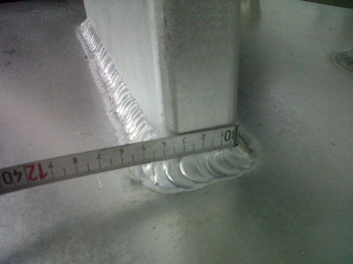

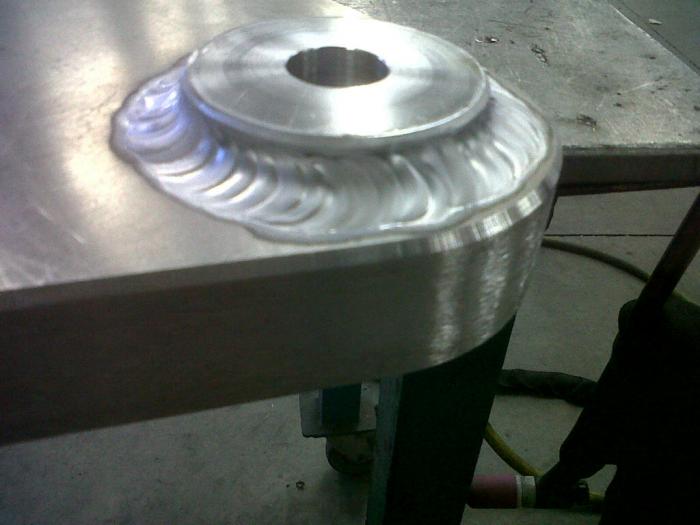

This is the problem one - the one that cracks. I do pre-heat. As soon as I stop welding to get another rod it starts cracking - I can see the crack when I stop - so therefore post-heating wont stop the problem either. The thick material is 30mm welded to about 6mm. It cracks all down the side of the weld on the 6mm material.
- prob.jpg (34.97 KiB) Viewed 2069 times
Ok so you can't see the crack on the photo but it has cracked on the bottom of the weld. Maybe the 2 materials aren't heated up to the exact same temperature? Can that cause the cracks - I don't think so.
- crack.jpg (28.99 KiB) Viewed 2070 times

Do you treat the "end of a rod" the same as the "end of a weld"? Meaning, do you fully button-off (fill the crater at the end of) the weld, just as you would if the point where you need more rod were actually the end of the weld? I ask because leaving a crater at the end while you pause to grab a fresh rod creates the same stress risers that cause undersized tacks to crack.Anton wrote:This is the problem one - the one that cracks. I do pre-heat. As soon as I stop welding to get another rod it starts cracking - I can see the crack when I stop - so therefore post-heating wont stop the problem either. The thick material is 30mm welded to about 6mm. It cracks all down the side of the weld on the 6mm material.
It's important here for a reason mentioned above... the 6mm carries/radiates it's latent heat FAR faster then the 30mm section. I do see the crack in the picture, and it's on the leg of the weld on the 6mm side.
Suggested above was a way to insulate the 6mm side of the joint to slow the cooling. Perhaps a reverse is in order... putting the 30mm section vertical, and burying the 6mm tube in sand or Vermiculite nearly to the weld depth, perhaps using something as simple as a cardboard box cut and taped to fit.

Every time I have come across this situation, the answer has always been heat, full penetration and weld size with regard to scale of the parts. Big heat, big tungsten, big amps and big welds. In other words, the parts preheated enough and a machine able to keep that joint wet throughout the motion of a significant weave.
I've used electric hot plates used for cooking to rest heavy plate on to get it good and hot. By hot, I mean like that of the 2nd pass on a typical weldment. Probably sounds kind of hokey but, whatever it takes. I've tried everything else. It's always come down to heat, penetration and weld size.
