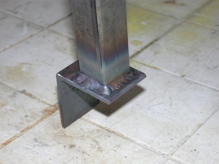

I fortunately practiced this, and gave myself a C-. half good, half blow through. At least I didn't ruin the project.
For an engine stand, I've got a little table I welded up of 1" sqare steel tubing, 1/16" tube wall. I'm now ready to weld the bottom of the table legs to 1/8" angle iron pads that hang over the main engine frame.
The welds are fillet, square tube sitting on a flat side of the angle iron. I set my TIG EN at about 75 amps, 3/32 tungsten (maybe should use 1/16"). I've tried both 3/32" and 1/16" filler, have aimed about 45-60 degrees at intersection, concentrating on heavy plate, but then doesn't bond to 1/16" tube. If I'm not careful, easy burn through on 1/16" tube - have done it on practice welds. Weaving seems to help. Not sure if I should use less heat and go slower, or more heat and go faster.
I would appreciate any help I can get.

This type of weld requires a little bit of puddle control and a steady hand on the torch. Direct the arc on to the 1/8" material and create your puddle there, then try to wash it into the thinner material. This may work without adding filler depending on how lucky you are. If filler is required, add it to the thicker material, then wash the puddle over. With a little practice you'll get it down and have a nice looking weld.
Also you may try changing the position of your materials. I bet you have the thin material vertical in the fillet position. Try to reposition it to horizontal. Now you are less likely to blast it with heat.
If need be and your machine has AC that you can adjust the frequency on, try a 120 to 200 hz arc. That will narrow the arc substantially. You don't allows have to use DC when welding steel.

CLOSURE: Well, I finished this job, looks alright. Sorry I can't show pictures, still don't know how. A couple added items made it much easier, for me. I did clamp a heavy piece just above the weld area to help soak up the heat on the thin square tubing. Second, my Lincoln TIG precision 235 has pulse control. I set it at 1 pulse per second. I'd start weld with three pulses, pedal-to-the-metal, no filler, to warm up area. Then I moved across piece, dipping filler into puddle at each hot point of pulse (also increased to 105 amps, so my welder stepped between 105 amps and half of that). Worked great on the 16 short welds. If I thought I was getting too hot, I just stopped for half a minute. Thanks again for all your help. Onward. Jeff

Hi. I wanted one last post, as I now can attach pictures. Here's one of the welds of the 1/16" inch wall square tube to the angle iron (1/8").
Battery table and control panel stand A 001.jpg (33.65 KiB) Viewed 6473 times

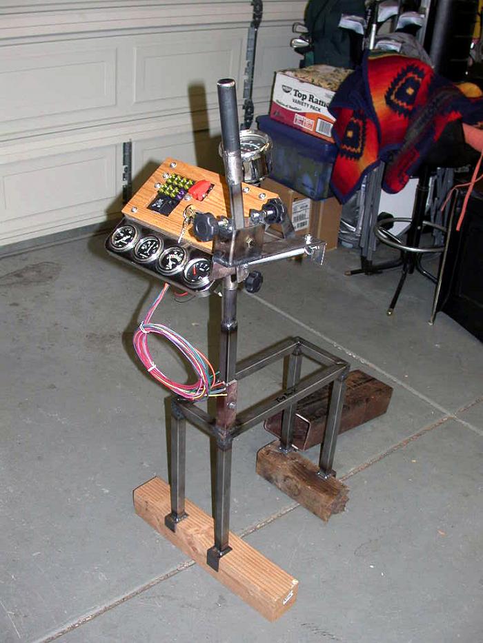

These angle irons are the base of the table and stand for the battery and control panel, shown here, almost done.
Battery table and control panel stand B 002.jpg (90.3 KiB) Viewed 6473 times

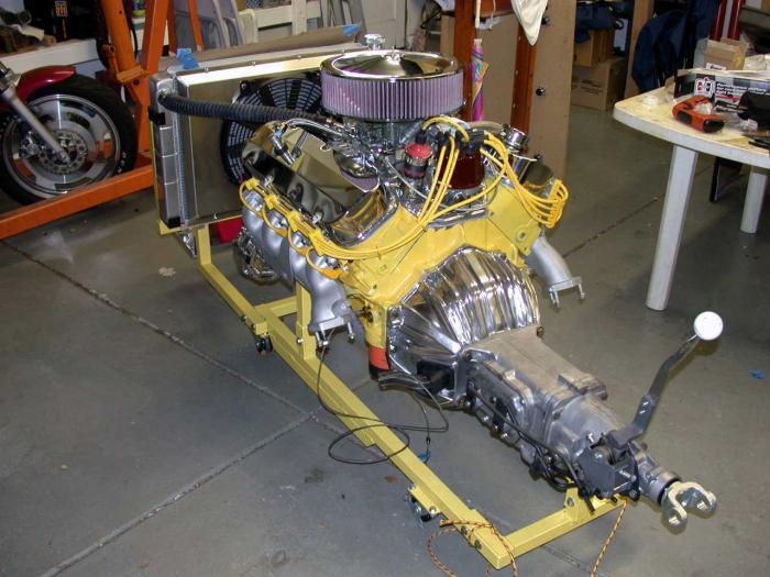

Finally, here's the engine with the stand I've built. The table above will go on top of the transmission, with legs resting on engine stand side rails. Thanks for all the help. Jeff

Those are some welds that will do the job....

I, too, would have MIGged it, but sometimes a process is chosen just to get practice in that process, rather than to get it done quickly, and I suspect that's the case here.
As for the welds, they look solid, good pentration. They're about as strong as they can be, and stronger than the square tube at any rate. Further practice will improve the cosmetics, which becomes important when you sell your welds... The customer usually doesn't know anything about welding, and can't see "strong" vs. "weak", so they look for "pretty" and associate that with "good".
BTW, with the HAZ on the tube versus that on the angle, I can believe that's 16 ga.

Thanks for the comments. I had some trepedation about showing my welds, but oh well. I'd someday like to try MIG, but as a retired guy, it won't be mine. It may have been better, but from my Oxyacetylene welding when I first started years ago, I came to really enjoy that method of melt, dip, move forward, dip, and that's why I picked a TIG machine as one of my retirement rewards. I really enjoy it. As a retired engineer I spend more than enough time on technical issues, but truly consider welding an art, true artisans. Came to appreciate that as an engineer in the refinery industry. I remember watching welders on a deck 150' up, laying mulit-layered beads on the top cap of a pressure vessel, 100 % X-Ray'd. Beautiful beads, very critical, wish the world at large could appreciate it. Those guys were exceptional, and I knew it.
Back to the science. I appreciate one of you saying politely that the welds were stronger than the square tube, which is truly 1/16" wall. I think what you were saying was the bead's bigger than needed. Agree, but I'd need hours to get it better and get good penetration, not undercut - at least for me. I just shoved in the filler on the pulse, kept from burning through the thin stuff, but with bigger beads. About cosmetics, that 1 pulse per second I used worked for these hands, but tends to make big puddles. I will try quicker/no pulsing in future.
About the stacked-dime ripples. I try to do that, but truth is it seems to me better to have a smooth, no ripple weld. Penetration is of course key, and maybe you folks could tell me why the stacked dime ripples are better structurally. As an engineer, sharp edges and very small radiuses that dime stacking can create if too exaggerated are stress raisers, by factors of 2-5 and upwards, depending on sharpness of edge. I saw a guy demonstrate that at a hot rod show. Edges were much worse, very pronounced. I'm guessing, but believe his dime stacking would have been smoother, curved if he'd used more heat. I think he had `cold' welds. I kept my mouth shut. They were beautious though. On vibrating parts under dynamic loads that is important. If my memory serves, MIG doesn't create ripples, but is a smooth weld, as wire feed is constant. I think that is a plus.
Thanks for feed back. Onward. Jeff

When I commented on the welds being stronger than the square tube, I didn't mean to imply they were "too big". From an engineering standpoint, sure, they were larger than needed, but from a practical standpoint, they're just fine. Putting down "just enough" can actually be more time consuming, and erring on the wrong side can induce weak spots.
I wasn't trying to "down" the appearance, either, though it may have sounded that way. I meant to say I felt them to be sound, quality welds, which a "customer" with no knowledge of welding might misjudge for purely cosmetic reasons.
As to "stacked dimes", that's merely an indicator/side effect of a consistent technique, and done properly, each ripple is rounded with no sharp points, or peaks and valleys into the parent metal creating stress risers. The step-size between the ripples should be small enough to be difficult to gauge without specialized tools. I cringe when I see stacked dimes in MIG welding, though... It may be attractive, but I'm unconvinced the technique that produces it makes a weld of equal strength to a "proper" nearly smooth bead.
