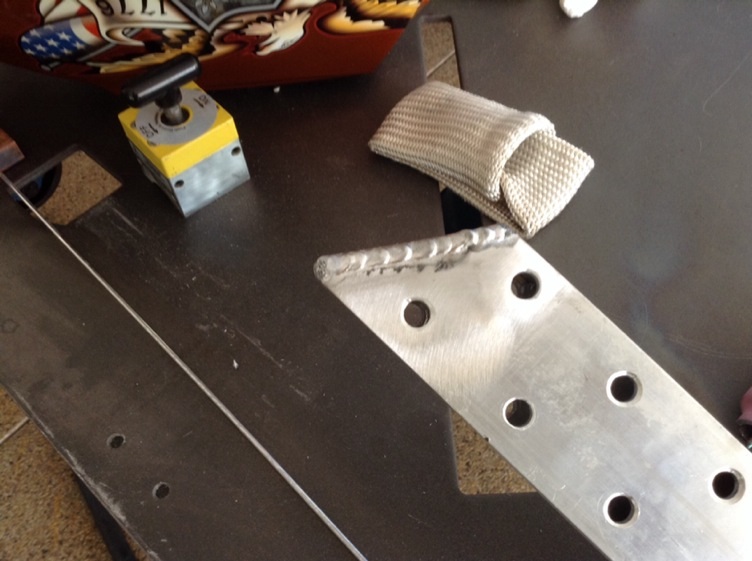

After a number of hours on the torch I have now realized a new problem occurring. I have continuos splitting/ looks like exploded end on my electrode. Tried all types and the only one that douse not seem to be affected is the green
My welds look much better and clean but this issue of the splitting tungsten has got me beat as I have tried several different batch electrodes of the various colors an it still happens
Is it a machine set up issue
Running 135amps on peek, 85on low with about 265 on the frequency.

Could you post a pic of the split end?
What size tungsten are you running? What machine? Sounds like an inverter since you have frequency adjustment.
Why are you running pulse and such a high freq? I don't have an inverter and weld on standard 60 hz with 50/50 balanced wave arc.
Pulse is not really needed on thick aluminum (looks like 1/8" stock).
What balance setting are you running?
Try more standard setup.
No pulse
100 Hz to 150 Hz freq
60% neg, 40% pos
If it's 1/8" aluminum, 150 amps or so.

Unfortunately I ground the electrodes to see how far the split went. And found out they vary between 3-10 mm the only way to explain how it looks is like the centre of the electrode exploded out leaving it looking all spiky
I am running 2.4 mm electrodes.
I am running pulse as that is what Jody does and I am self tout from watching his videos. Also I don't have a foot pedal with this Chinese Shiyo AC/DC welder
Frequency is up as I find running low frequency I tend to get a lot of arc wander and it seams to suck the filler material onto the electrode easier if low frequency. Maybe just my technique due to arc wander and thus hold too close an arc?
I run about 50/50 arc balance as I seem to also loose heat when I run to much cleaning.

Well if uou are getting long cracks it mayb from how you are cutting your tungstens to length. Some tungtens are very brittle so you need to be careful if you are using the break technique especially 2 percent lanthated and thoriated, I recommend cutting them. Sorry what I meant by lowering your balance was turn your machine to max cleaning when balling tungsten on the copper, than turn it back to penetration when welding. The normal settings I use is a balanc of 70. So that 70 percent penetration ( dcen) and 30 percent cleaning (dcep). Hope some of that helps you. And I high recomend getting a footpedal for welding aluminum.

You can use pure(green) on a inverter, I do for the xray alum pressure tanks I do so I don't risk tunsten spitting. I know you said you were running a balanced 50/50, mayb try 70/30 add more dcen so you are not putting so much heat on the tungsten from the dcep. Also try the 2 percent lanthanated those things are awesome. Hopefully that helps.

I find I get this problem it the initial ignition ark is too high. HF and high amps tend to split tungsten's. Try setting your machine so that your initial ark amps fairly low, then have it upslope over about 3 seconds. This should stop the splitting.
Why dose no one over there use Zirconiated tungsten's? They were designed specifically for welding alloy, and do an exception job of it
