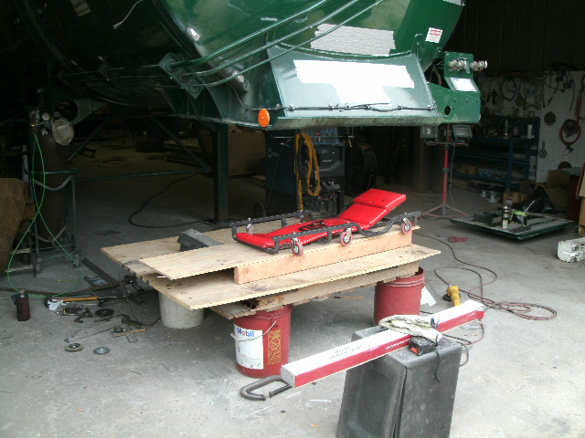

Weling 11' of 4G Aluminum TIG, 3/8" 6061, in three passes.
Comfortably, though... Here's my perch:
- GEDC1032.JPG (195.34 KiB) Viewed 1928 times
- GEDC1037.JPG (208.01 KiB) Viewed 1928 times
lol the buckets are a nice touch, were you out of milk crates?

Buckets were 4" taller than milk crates...

I do like the "work platform" - your nearly qualified for farm jobs - just need to get comfortable with something similar on the edge of a grain store / slurry tank etc or tied to some old ladders ! - I used to like a pallet on the forklift for this type of work - but apparently this is no longer allowed as a forklift is not tested for lifting people ! gotta love those safety guys.
