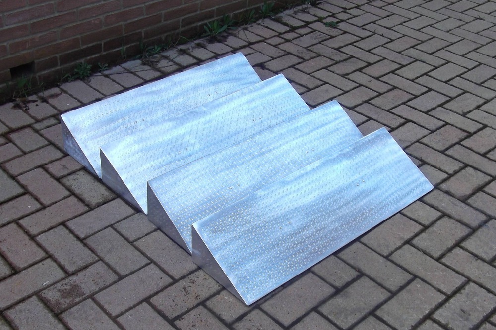

I've read different opinions on the matter, so I'd like to hear your thoughts also: is it ok to flatten down weld beads on aluminum, or it takes away to much strenght from the weld, imposing too big of a cracking risk?

Grinding weld on any material will remove strength, this why it is not done in critical applications. If you are going to do it on aluminum a bevel greatly helps as well as.having full penetrations if allowed,.if it's not allowed, you will definitely want a bevel otherwise your weld will most likely crack.

And what about other types of joint, like an outside corner joint for example, where you have to smooth the weld out and round the corner for cosmetic reasons? Assuming you've got enough penetration, I would suppose that would not be a problem, wouldn't it?

Grinding down outside corners does work well as long as you are careful and do not "flatten" or remove to much of the fillet. Same goes for t and lap joint just becareful not remove to much of the fillet.

I am not to familiar with the metric system. But basically as long as your joint fit up is good, a true corner to, you should be fine. When I am,welding a outside corner that is going to be ground I make my welds convexed so all you are really doing when grinding is simple smoothing out your coins in your weld beads. If you have a flat or convexed weld bead you will have to over grind to.get a nice radius. I usually don't not like to grind down outside corner joints on thin aluminum like.040 and thinner. At my first shop we had problems with welds cracking on .030 aluminum outside corner joints that were ground down.
When welding outside corners that are going to be ground in thinner aluminum, you don't want to just fill the notch left by the open corner, but also keyhole weld it for penetration beyond the juncture of the inside of the corner. I see this neglected a lot. In this particular case, it cost this company millions of dollars in ecologic impact fines.
