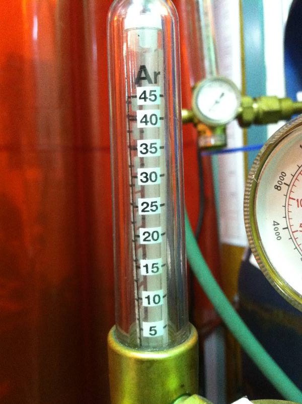

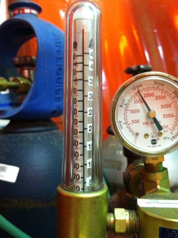

I'll try to remember Monday to take a pic, or at least write it down. I have several flowmeters at work that are graduated in both He and Ar.

Here are a few photos of the regulators at my work. Hope this will help.
- Optimized-IMG_2315.JPG (119.05 KiB) Viewed 2142 times
- Optimized-IMG_2316.JPG (121.26 KiB) Viewed 2142 times
- Optimized-IMG_2314.JPG (111.36 KiB) Viewed 2142 times
Hey thanks do when helium pushes the ball tpo 20cfh in an argon flow meter its actually 60+ CFM of helium. now i know why the right mix of helium was just gettinhg the ball to lift half way to 5 cfm in the argon flow meter. Thank for the pics man!!!
