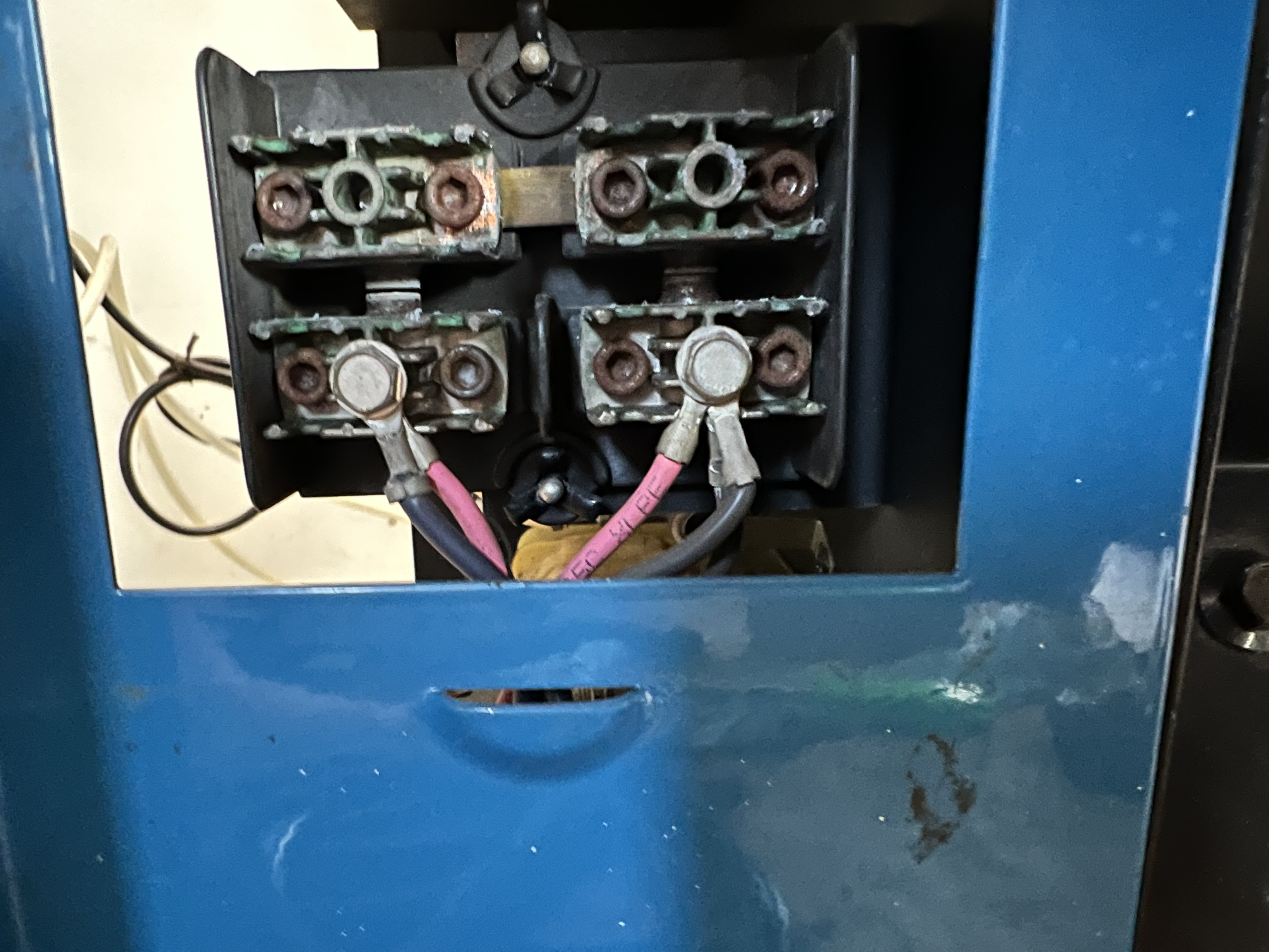

Well I found one problem. I’ll clean all this up and get rid of the corrosion and put in new fasteners. The points according to the manual are the same as in the Dynasty 700, same part number.

Points shouldn't have anything to do with it since they don't change the cleaning function which is just AC balance.

This got put a bit of the back burner while I sorted some health stuff and had a surgery among other things. While I at it over christmas I ordered all new points assembly and everything so now that I am a bit more "alive" will put it all back together. While I am at it just because I am in there I am going to replace the gas line hose inside the machine logic being hose doesn't last forever and this machine is 20 years old.
But what is kind of funny and will confirm sometime soon when I have the energy to take care of it. But I talked about all this with the Air Liquide rep and asked him what the likelihood of a contaminated bottle would be. He said it would be incredible rare but has happened. He said just when I get a chance take it back and have them flag it as a potential contamination and they will check.
I just this last week in the middle of me going through my surgery stuff got an email from the Air Liquide guy asking for the bottle information. He emailed me today confirming that they did in fact have a bad batch of argon bottles and for me to swap mine out.
Miller Syncrowave 350LX
Esab Power Compact 205
BOC 185DC Tig
BOC 185DC Tig
William Payne
- William Payne
Joined:Sun Jan 17, 2021 6:15 am
Location:New Zealand
I forgot to update this for anyone interested. So between new points and a new gas bottle everything is happy again.
