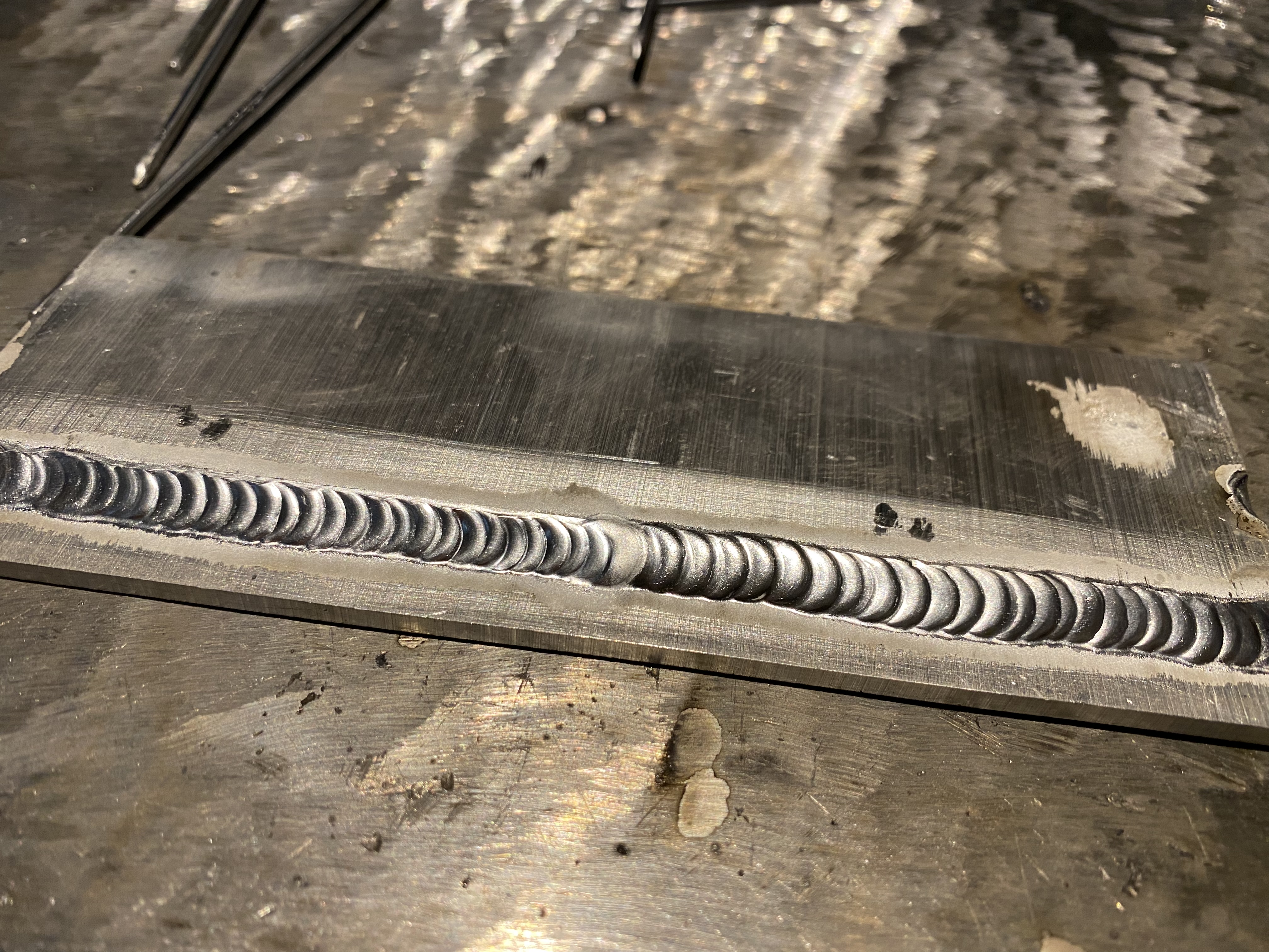

What do you guys think?
cj737
    Thu Sep 29, 2016 8:59 am
Spacing of the puddle is nice. Material is way too hot. Insufficient filler size for the material thickness. This is very evident by the chewed off top edge of the material.
If you are running the bead and stopping, let the material cool way down between segments. Or, clamp the material to some thick chill blocks to help control the heat saturation.

This was my first time running tig

For what it's worth, I think your doing pretty good for a novice tig welder. Practice, practice, practice and you'll get much better.
