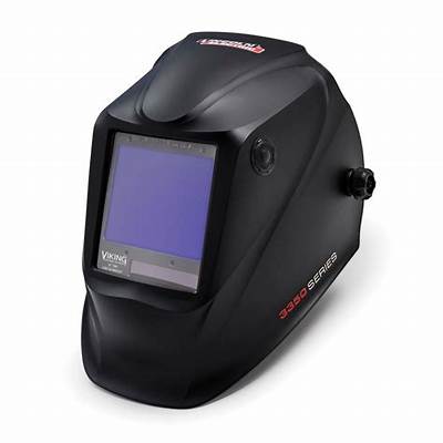

Should get a decent helmet. Doubt I need anything fancy. Is a Lincoln 3350 an okay choice?
When I was in Jr High School metal shop, I was trying to stick weld. Couldn't see jack through the helmet. Lifted the helmet to see what I was doing. Woke up the next day blind! Couldn't see my hand in front of my face. Cleared up over the next couple of days.

Yes, that helmet is fine. Actually, better than 'fine'.
