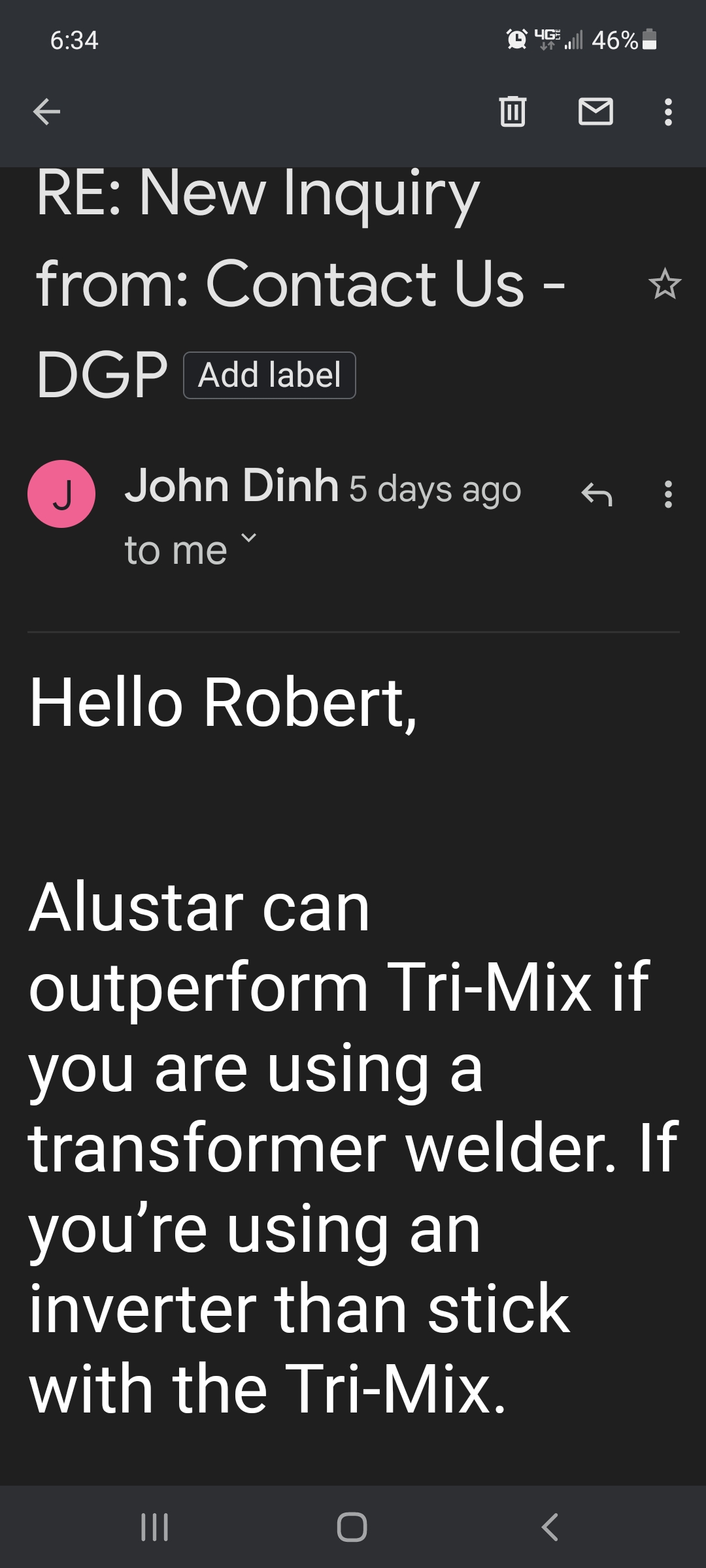

So I emailed wolfram as I was interested in these. I use their Tri Mix. They informed me that if using an inverter like my Dynasty to stick with the trimix. The alustar would have an advantage on a transformer power source.

I was emailing Manuel Mar - Product & Project management at www.wolfram-industrie.de and his email was (mar@wolfram-industrie.de) I told him that I had a Dynasty 400 and all the different setting I was using, he said that should work just fine and it has been.
I use WS2 WITSTAR for all my other welding but for aluminum the Alustar works the best.

I have great luck with Alustar on my Dynasty 400 and like I said it was recommended by Wolfram Germany the Wolfram trimix will work on everything but I weld 99% aluminum Mig or Tig when you have invested a lot of money in welders that do what you do the most of it pay off my Miller AlumaPower 350MPa welds look like Tig welds but to Tig weld 1" aluminum plate the Mig welder is the way to go this is the first piece I tested with the AlumaPower 350MPa
