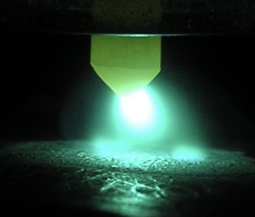

I have made a bit of a breakthrough with my aluminium tig welding, which I thought I’d offer up for your comment and thoughts, and also because possibly it might help others, or at least give suggestions on things to think about. My problem was with the electrode parameters; I hadn’t realised just how important they are.
My aluminium welding has been a bit hit and miss, and the one joint that’s far more miss than hit is the one-inch diameter tube-to-plate. I’m a keen fan of Jody’s aluminium drill but I hit a point where further progress was minimal. So I got some tube and plate and tried to see where I was going wrong. I used 2% lanthanated electrodes and soon realised that arc instability was my problem; I was nearly always fighting to control the arc, especially at lower current settings. Getting a focussed arc was also problematic; increasing the AC frequency helped, but it didn’t solve the problem. So I’d burn through the tube in places, get undercut, and get an inconsistent weld bead.
As arc instability was most evident at low currents, I set current to 25 Amps. My settings were 65% EN, 200 Hz, 25 Amps. I started with a 2.4mm 2% lanthanated electrode. (AC frequency seems to help focus the arc a little, but it’s not like night and day, as Jody would say, so I left it at 200Hz.) I found that:
a. The arc was unstable, and changing the tip angle didn’t help.
b. A 1.6mm electrode was, if anything, worse, and again tip angle made no appreciable difference.
c. A 3.2mm electrode was also unstable until I ground a tip of about 100 degrees - the apex was 2mm from the start of the shoulder of the tip. With this angle I had a rock solid arc at 25 Amps (at 50Hz, too)
electrodes beforehand ceriated left lanth right.JPG (2.07 MiB) Viewed 11205 times
lanth 25 amps.JPG (276.42 KiB) Viewed 11205 times
d. Having read that ceriated tungsten is "best at low amperage range", excellent for arc stability and is recommended for aluminium with inverters or transformers, I tried a 3.2 mm ceriated electrode at 25 Amps, but found the arc unstable. It was unstable at 100 degrees tip angle and even more unstable at a sharper angle. (All electrodes were ground longitudinally with diamond wheels.)
ceriated 25 Amps.JPG (249.23 KiB) Viewed 11205 times
Having now got control of the arc, my next tube-to-plate weld was easy and professional looking - no undercut, no burn-through, and no battling with the arc. (1.5mm tube to 3mm plate - 3.2mm lanthanated tungsten, 100 degree tip angle.) The results of my aluminium drill are now looking a lot more like the results Jody gets.

Re: Arc Instability, arc control, electrode parameters on Aluminium
Posted: Fri Sep 03, 2021 2:01 am
by tweake
martinr wrote: ↑Thu Sep 02, 2021 10:03 am Image
nice pic, it really shows that the arc comes off the side of the point. a fine taper makes a wider arc, while a steep taper makes a smaller arc.

Based on the pictures, I feel the results are skewed. I knew this contradicted my own observations, but I couldn't tell why, initially. The arc shot with the Ceriated electrode depicts a longer arc length which will in turn affect arc stability. In my eyes, it's pretty clear to see the difference.

Thanks, Oscar. I thought I had set the electrode gaps the same with a 2.9mm thick piece of Al, but possibly I knocked it between setting and running. Anyway, it's an excellent chance to see if I could improve on the photos, which I might have done except that I must have been closer to the ceriated electrode because the ceriated electrode looks wider , and, try as I might, I can't edit the photos to the same size. And even though the ceriated looks hotter than the lanthanted, they were both set to 25 Amps, foot pedal fully down, and same camera settings, same No 9 filter. I guess that I've got a long way to go to match the quality of Jody's arc shots
Here's the lanthanated tungsten 3.2mm at 25 Amps:
lanthanated tungsten CK (2).jpg (21.7 KiB) Viewed 11119 times
and here's the ceriated tungsten 3.2mm 25 Amps
ceriated tungsten CK.jpg (27.94 KiB) Viewed 11119 times
The difference between the 2 electrode types was a bit of an aside, what I was most interested in was the fact that by going to a larger electrode and setting the tip angle to around 100 degrees, I got significantly better results.

Also, the grind angles are inconsistent. In the last pic both look less than 90°, with one closer to 75°. Even in the first pic, both look acute. With amperage this low, all these seemingly hair-splitting differences play a huge role, IMO. I do salute the effort though.
This is just shy of 100°

Confirms my suspicions. Both are acute, and not identical. One has a smaller included angle. That throws off the data.

Today's photos.
This time I decided to grind as obtuse an angle as I reasonably could , by hand, and to compare again ceriated with lanthanated at the same settings.
Lanthanated tungsten:
lanthanated 01.jpg (75.79 KiB) Viewed 11071 times
lanthanated 02.jpg (94.7 KiB) Viewed 11071 times
Ceriated tungsten
ceriated 01.jpg (79.98 KiB) Viewed 11071 times
ceriated 02.jpg (88.66 KiB) Viewed 11071 times
I'm putting this to bed now, you'll be pleased to know; I've got as much as I want out of it - it's cleared up a couple of my misconceptions.
I'd still like to hear how you grind your electrodes - by hand or by dedicated tungsten grinder, such as the Sharpie or something similar, and what difference you'll feel it makes. (When I say 'by hand', I mean by hand on a dedicated tungsten diamond wheel/disc, not on the shop bench grinder that's clogged with all sorts of different metals.)
