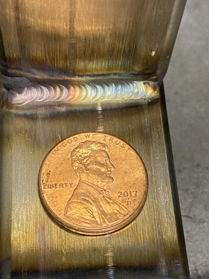

G-ManBart
    Sat Aug 01, 2020 11:24 am
This was literally my first attempt using .035" wire on what I'm pretty sure was 16 gauge stainless....not perfect, but not a disaster either.
