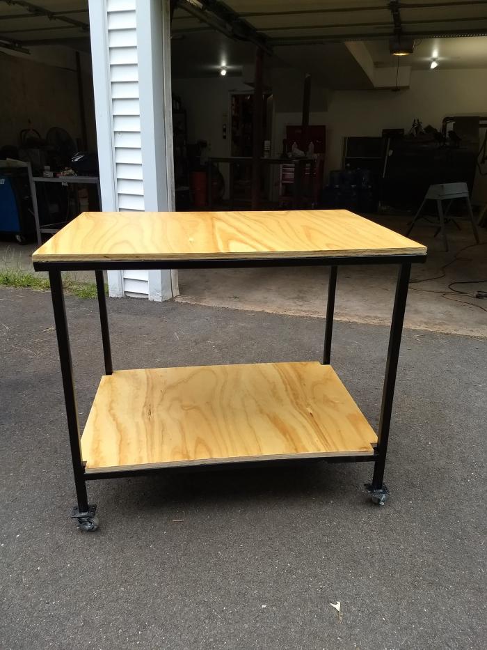

Pics attached are a little laundry cart/folding table I build for my wife, out of 1 inch steel square tube. It was cut on a $200 Harbor Freight band saw, and welded together with my Hobart Handler 190. The whole thing took about 8 hours to build, and I am sure other people could build it much quicker. I strength tested it by having 600 lbs of men sit/stand on it. Not very scientific, I admit, but it seems strong enough for my needs. You are not going to do this in 8 hours with aluminum for quite a while, and honestly I am not sure I could either. And blowing through with the MIG was a non-issue. This stuff was .08 inch wall thickness IIRC. Pretty simple to build, really. The cart weighs approximately 40 lbs as it stands, finished.

Nice table! I love making something like this - purposely built to specific dimensions (I'm sure you could have bought one which could work, but not fit quite as nice as a custom one you made.) And that brings me to answer your question in regards to the reason I'm buying a Tig - to master welding aluminum or build the rack - it's neither, and both. Because this project came up, it's a good excuse to get one and try it out. I will hopefully learn how to Tig weld AND get this project done. And I'll get more use of it down the road.
It's a lot like your welder and table. I'm sure you weren't thinking of buying the welder JUST to build the table. I'm sure it allowed you to learn welding AND brought you savings each time you used it on a project.
