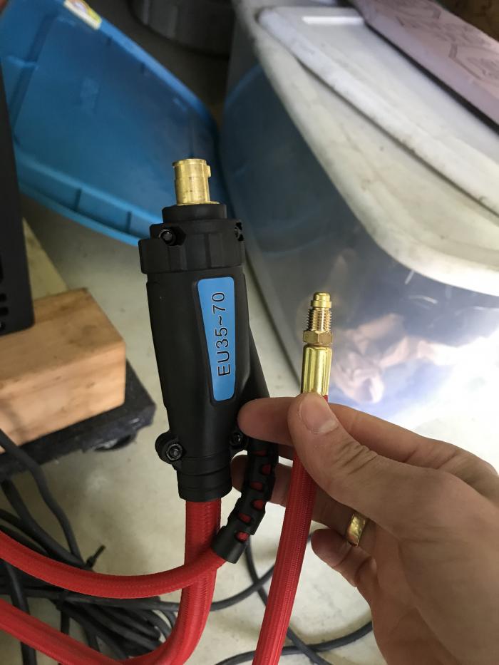

Well I got my 17 torch and cable (right) and then realized I totally forgot to think about the welder connection (left, from 26 torch). What do you all recommend?

by G-ManBart

R-mm wrote:Well I got my 17 torch and cable (right) and then realized I totally forgot to think about the welder connection (left, from 26 torch). What do you all recommend?
You're going to need an adapter. Arc-Zone.com has a pretty good selection of adapters when I've needed one in the past.

I think this is what I need. 1/2in dinse is what the Everlast has and 3/8in-24 is the connector on the 17 Torch line. Bummer it has such a long gas line, I only need 1-2'
https://www.arc-zone.com/safeloc-connec ... ath=5_2432&

Posted: Mon Nov 09, 2020 10:56 pm
by R-mm
Hmm maybe not looks like a quick connect on the gas.

by BillE.Dee
there are adapters available to change over to quick connect for both water and gas. Make sure you get the CORRECT one. I know Arc Zone has them as I bought mine there OR you may find them from other supply companies online.

by G-ManBart
R-mm wrote:Hmm maybe not looks like a quick connect on the gas.
I would expect them to have an adapter that would accept the power pin, and have a quick connect gas fitting (Everlast uses 9mm size on all the machines I'm aware of). There is an adapter for a RH 5/8" gas fitting to work on a 9mm quick connect:
https://www.arc-zone.com/quick-release- ... 13_673_682&

by R-mm
Precisely right, I ordered one today after calling Arc Zone.
