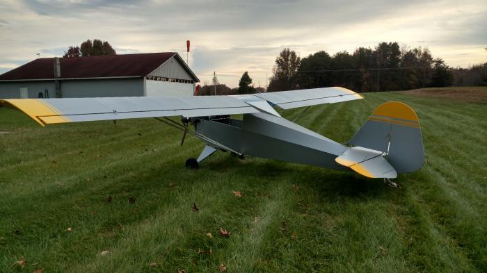

This is a strut attachment point on a 5/8 by .035 fuselage tube. The ones that were built back in the early 80s were mig welded and I'm not doing that if possible. Just wanted to know if there is any advice to get this welded up from the inside of those cross tubes with a TIG torch and do it in a safe manner. This is a picture of my other project that's finished this is on a new project. thanks in advance for any tips on how to get in here and weld this to the plate without killing it !!! Guess I'll have to light up on the .080 plate and sneak up to the 5/8 tube.
