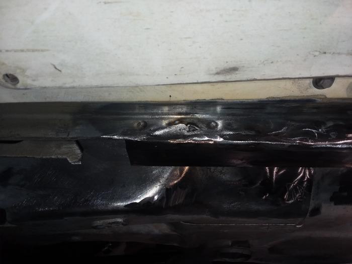

I'm a pretty good tig welder but I need some help. I'm welding in some subframe connectors on my firebird and most of the welding is overhead. What are some of the tricks to keep the puddle from falling?

Don’t slow down. Keep your travel based on what the puddle wants. Reduce your amperage slightly for overhead and vertical up. Clean the contaminates out of the weld area. Overhead should weld like any other position with TIG.
If the metal is heating to the point of falling it’s because either the amperage is too high or your travel speed is too slow or both.

Well I welded the topside of this subframe connector and had some problems with it as well. As it turns out in the 80's (my car is an 88 Trans AM GTA) that they electogalvanized with zink. I found this post online about it https://www.hobartbrothers.com/index.ph ... turnid=523
Pretty interesting I found the metal cored wire he's talking about it's E70C6 (not s6) I went to my welding supply store and they looked at me funny. So I looked online and you have to buy a 33 lb roll at 3.50 lb and it's. 045 wire. So on I went searching.

So my next idea I just to make a copper heat sink out of some pipe. I'll Cleco it to the back of the thin car metal that I'm trying to weld to my 2x3 box tube subframe connector. I can't tell you how many holes I filled this weekend.
Can you provide the wire diameter you are using, the heat settings, etc. to see if perhaps some "tuning" of your current conditions can get you where you need to be?Kfactor239 wrote:So my next idea I just to make a copper heat sink out of some pipe. I'll Cleco it to the back of the thin car metal that I'm trying to weld to my 2x3 box tube subframe connector. I can't tell you how many holes I filled this weekend.
Filler wire size and type
Amps
Cup size, CFH, tungsten size and type
Metal thickness (of your car)

Let's see I'm using 1/16 Er70S6 rod. Amps I can't tell you I'm using just my footpedal but my machine goes to 165 amps. I'm running a #5 cup on a 3/32 red tipped tungsten and the metal thickness carts from prob 16 gauge up to maybe 1/8 or more (some pinch welds have several layers of sheetmetal) the square tube is probably 120 wall. CFH I've got set at 15

I ran across this article about welding hot dipped galvanized Steele it's not electro galvanized but it deffinetly is telling me why I'm having such problems.

Based upon what your setup is, I would use a #7 or #8 cup with a gas lens (if you're not) and be dead certain that you're only using a max of 120 amps at full pedal. A nice tight arc on clean metal and it is just like welding flat.
When you do weld overhead, and you might be laying multiple passes, you have to pay attention to interpass temps. If the first pass is still smoldering hot, then the subsequent fill pass will droop because as you weld, you are reheating the base pass plus the fill pass. Then gravity is your enemy.
You can practice/test this on a flat plate with a root pass, then position it overhead and run a fill pass. You'll notice the "droop" immediately.
Of course if you aren't cleaning to bare metal, TIG won't work. Since you indicated flat is not a problem for you, I assume you are also being diligent overhead. Goes without saying...

Now that I know what I'm up against I kind of understand my problem. It's not welding overhead at all it's this metal. After reading about welding electro galvanized metal I did what was suggested I cleaned everything front and back to bare metal and beyond at least 3 inches back. Started today with a 7 cup cfh up to 25 and started. The metal just pops and a lot of the time not even near my puddle a good inch or two away. Being that I am trying to weld along a pinch weld of several sheets of sheet metal it's impossible to clean the zinc from between the sheets. Honestly I'm amazed I've done as good as I have. So I'm done trying to tig this and I'm breaking out my cheesy harbor freight flux core welder to finish it up.
Kfactor239
- Kfactor239
Joined:Fri Jan 03, 2020 12:18 am
I put some pictures attached you can see some of the hole that blew notice they aren't near my weld. And this isn't half of it I've already probably filled 20 or so holes. My original welds were pretty trashy it's about impossible to keep your tungsten clean as the zinc is constantly popping on you.
