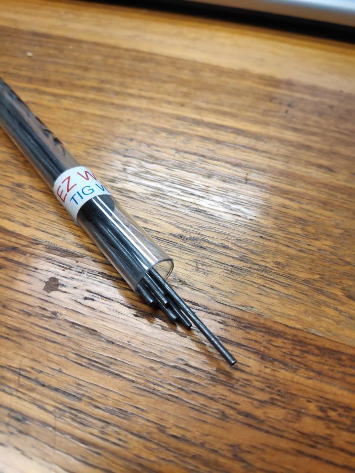

Get you some EziWeldTig Wire and just tig it up. It's all I use these days as long as the joint hasn't been butchered by someone before me.

No it's neither. It's a genuine solid ferrous tig fusion wire. No flux no brazing. Doesn't flow like say er70 and you think you're not wetting in well but it all works out. Don't know how, it just does. I've also used it to join cast iron to steel successfully.

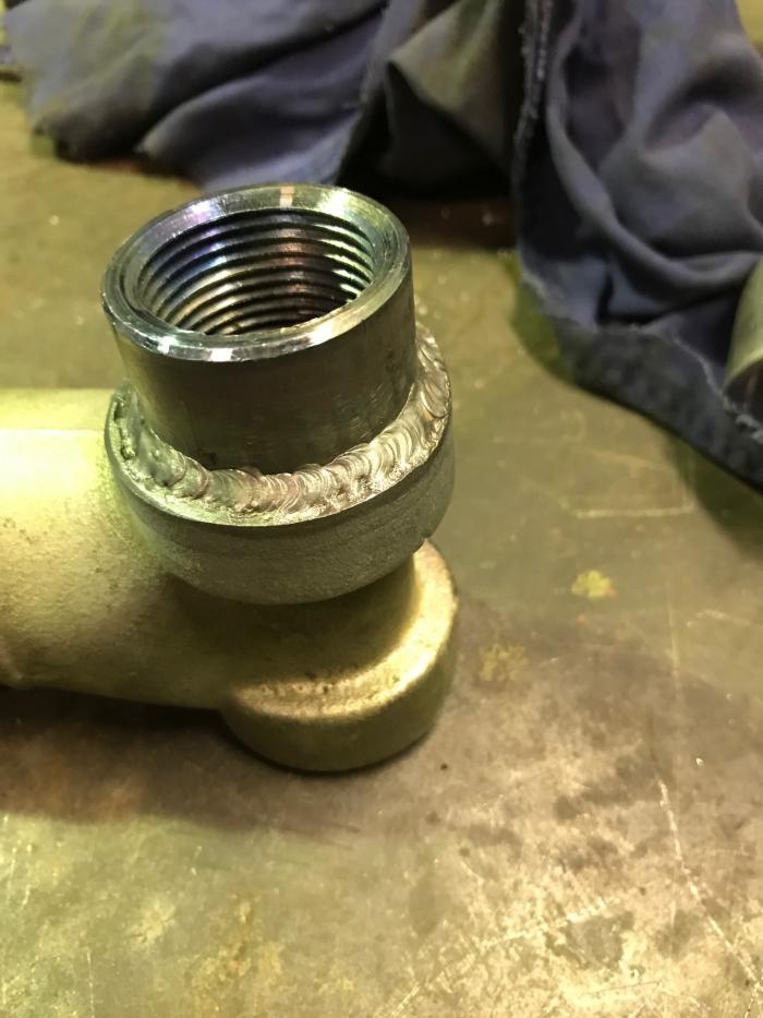

Here's a pic of the wire itself and a cast iron to steel joint I did a while back.
This bad boy has been in service for about a year now, no probs.
The wire is expensive but a little wire goes a long way because most cast iron repairs tend to be short crack repairs or broken bolt tabs or mounting feet. If it was a big thick machine base that required serious bevelling or if some do-gooder bevelled the hell out of the joint before I got called in I'd certainly rethink the repair process and probably go for preheated nickel rod or braze repair.
The idea with this EziTigWire is to tack the pieces back together or end drill cracks, then with a small burr or zip disc open up a small partial thickness bevel to allow the filler to flow in but using minimal amounts. Cast iron repair is nasty always and you will get schmutz float to the weld pool surface which might cause concern but it wire brushes off and comes up good. I haven't had any failures yet after having done several repairs already.
