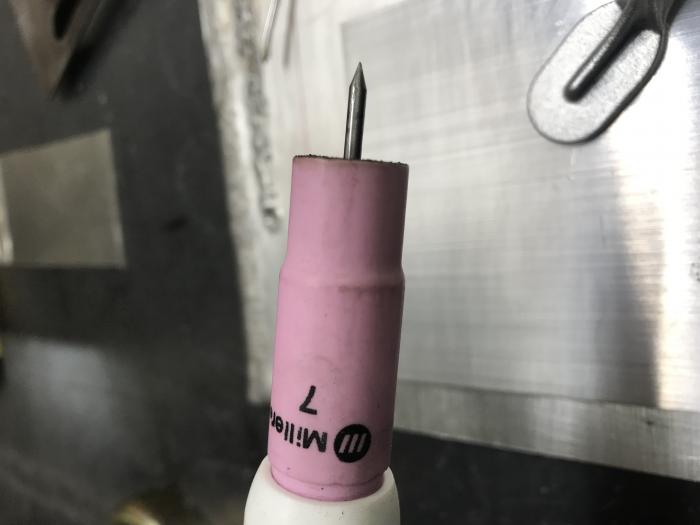

Hello all,
I'm trying to teach myself how to TIG weld aluminum. I've watched the WT&T and ChuckE2009 videos half a dozen times (each) but I just can't seem to get a decent puddle to form.
Here's my setup:
Miller Multimatic 220
3/32" grey tungsten (2% ceriated)
3/32" filler rod
1/8" aluminum
100% argon set to 15 CFH (I've tried as high as 22 CFH)
#7 cup
I'm using the auto-set features of the MM220 which for this combination says 135 amps (I have a foot pedal). I'm cleaning my material with a wire brush and then acetone. I've attached a picture of my ground tungsten in the torch.
When I fire up I try and ease into the amps (I don't just full mash). I see the frosty cleaning action start but I never get a good puddle. If I go full pedal I get a gummy mess of a pool that has some sort of film around it but it never flows - it just clumps. If I try and add filler rod it doesn't melt off but instead breaks off or starts to melt then sticks back onto itself.
Your guidance as to where I'm going wrong and what I need to work on is greatly appreciated.
Thanks,
j
tungsten grind and stick-out plus cup

First, that’s a standard collet body and cup. Drop to a #5 cup and shorten your stick out. 10cfh. I set my machine to 170 amps for that material thickness. Aluminum takes more amps than steel to get a puddle, but once you get going you can back off the amps as aluminum keeps the heat.
An aluminum puddle is very different than steel, so get accustomed to seeing a difference. Bump your amps to 150, mash it, then taper off as you go. Don’t add filler until you’ve got a wet puddle. Keep your torch pretty upright too.

I suggest that you cut the Tungsten stickout to about half of what you show in the photo. That will improve your gas coverage.
From your descriptions, it sounds like there is still a lot of oxide on the base metal. On fresh clean aluminum, a quick hit with SS brush will clean up a thin layer of oxide good enough to weld. On old dull aluminum with a heavy layer of oxide, you can wear out a new brush, and still not be clean enough to weld well.
I would try something a bit more agressive, like a sanding pad. You want the base material to have a bright shine before you wipe it with the Acetone. It is more critical when you are learning.

Thanks again for the info. It would seem that my biggest problem right now is material cleanliness. I took a flap disc to the aluminum and that has made a world of difference. Apparently, though, my filler rod is filthy. I can see globs of yuck entering the pool when I dab. Lesson learned - Blue Demon rods are gross. Fortunately I only have what little came in a starter kit when I purchased the welder.
Mashing and tapering off (instead of ramping up) has also helped quite a bit. I haven't yet swapped cups yet but I did shorten my stick out by about half.
I'm going to focus a bit more on material and rod cleanliness and try and get my technique a bit more consistent before I ask about tungsten frying. :lol:

Often times, your actual arc length causes some of what you are describing. Skip the flap discs, they embed crap more than they remove it. A good scrub with your stainless brush followed by an acetone wipe of the material and the filler is adequate.
Regarding your cup... Any time I use larger than a #5, I switch to a gas lens. It provides better coverage and shielding. Its not needed on the smaller cups (<5) as the orifice of the cup is so tight, you aren't welding an area that benefits from the extra coverage. And with a smaller cup, you can get better penetration with the same amount of amps.

clean the filler rods. even good brands will have yunk on them. also 4043 filler will often have peppering in the weld.
also watch you torch angle. if you point to far forward you will melt the rod as you dab and that ends up as a glob of snot in the puddle.
ceriated tungsten is not great for aluminum, i see its recommended for low amps. 2% lanthaned is a good all rounder.
cleaning flap disk can simply smear the oxide into the aluminum. however imho it can work well if done at low speed (variable speed grinder). most of the time brushing with stainless wire brush in one direction works well.
just remember to clean up all dust, shavings etc. it has a real nasty habit of being sucked into your tungsten.

Hey - can I suggest that you "blunt" your tungsten a little. From my experience a sharp grind like that is good for steel, stainless, etc. When I get to aluminum I make the tungsten quite blunt and it seems to help me direct the heat better. I think cj737 suggested this and it worked for me.
Just another suggestion to add to the list... :)

Pepper in your welds can be a couple of things. It can be too little gas coverage or incorrect A/C balance. Set your flow to about 15scfh and adjust your A/C balance so you can see between a 1/16-1/8" of frosting at the edges of the weld. The frosting is Cathodic etching and that occurs best in the area covered by the Argon flow. Too much Argon and you'll cool the material too much and the etching will be less effective. Too little argon and the weld will be wider than the etch area. Both will cause peppering. I should also mention that cup size can also make a difference. Try matching the cup to the width of the weld you expect to produce in a single pass and go up one size.
Here's a tip: Go to Lowes or Home depot and get some aluminum flat stock to practice on. The stuff is about the worst AL I've ever tried to weld. If you can get that to run clean beads you will have mastered the concept of Cathodic etching.
